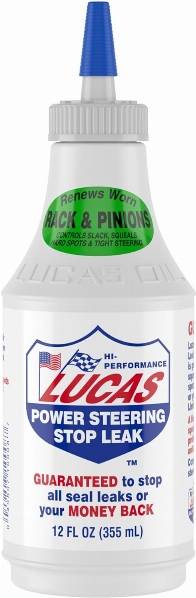

Well you could try some lucas power steering stop leak and see if it helps. I mean short of repairing or replacing the pump or steering gear.

I'll try the stop leak above and see what happens, but I'm afraid it's a big enough leak that it may not work. Could be my fault anyway, since I just rebuilt the front end last winter and now everything else is nice and tight, no slop...it's transmitting all that road feedback into the box.
