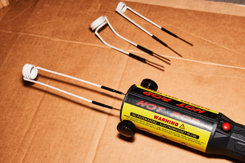

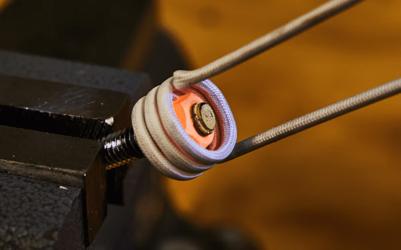

I tried a heat gun and a propane torc.. . What is an induction heater?
Cool! I have NEVER seen one of those!
the good thing about this tool is, you can bend the end so if you have a tight spot it will fit on the bolt head or nut as needed
