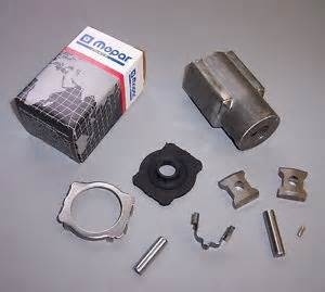

Is the spring pin in? It's the pin that goes in the collar that holds it to the gear box.

Is the spring pin in? It's the pin that goes in the collar that holds it to the gear box.View attachment 401192
