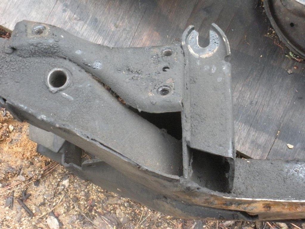

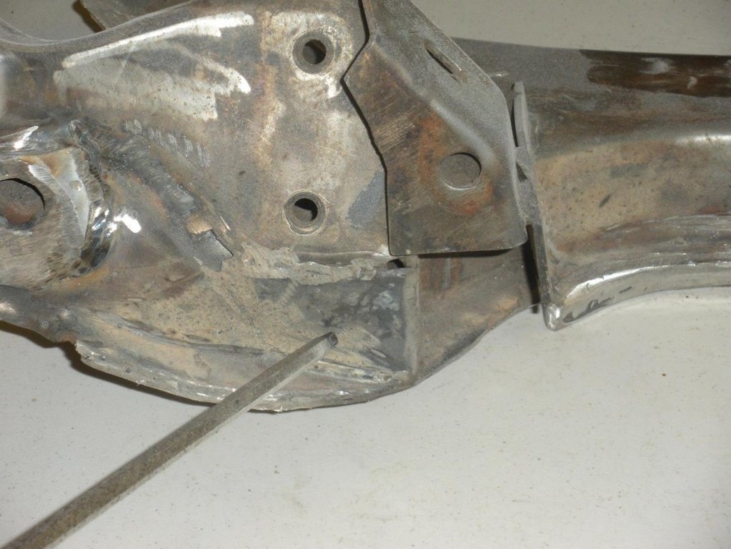

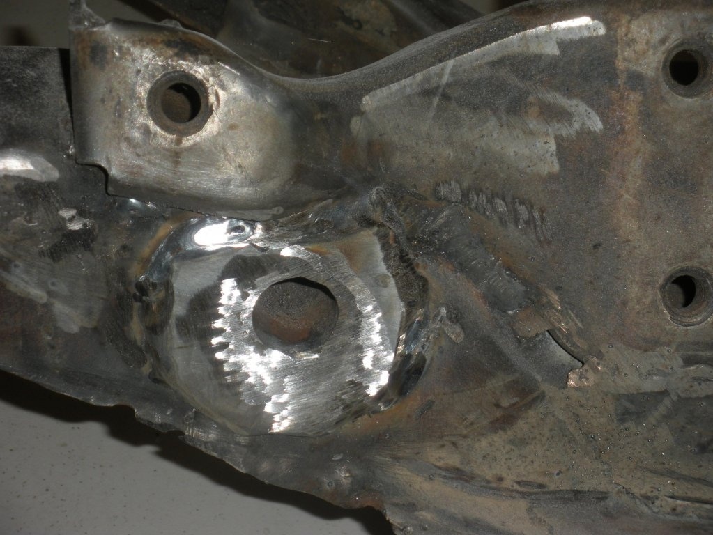

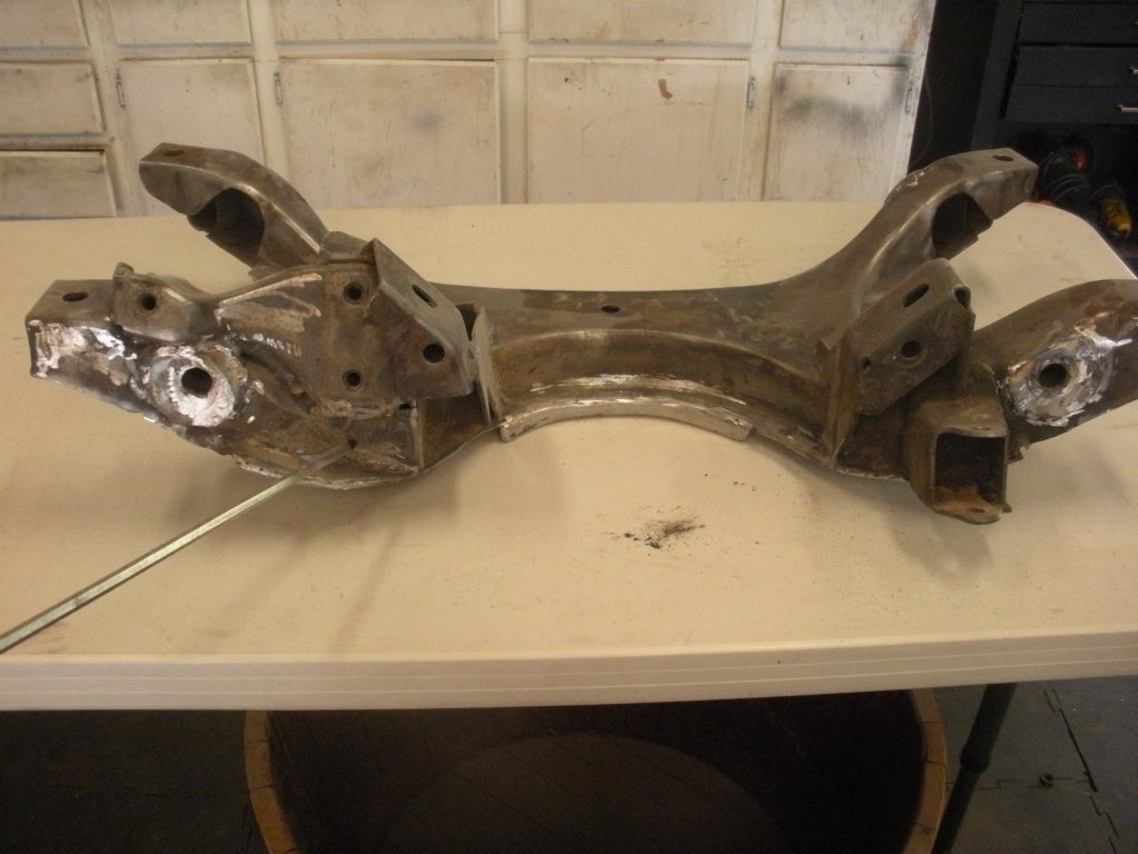

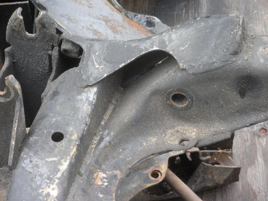

I added metal to the open areas in my K member to support the steering box mounts. ZERO flex here.
This is an A body K member but you can see the open voids that allow the flex to occur.
