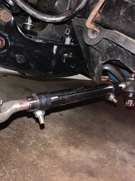

I had a shop replace the manual steering box. When they reinstalled the steering wheel, it was suddenly cocked, like yours, for the first time ever. They had to have made some kind of positioning error, because the tie rods didn't spontaneously get out of alignment.
My point is that somehow mine got reinstalled crooked.
I have the car in another shop for a major amount of add ons and other work.

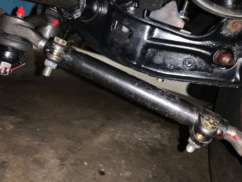

Changing to power steering, Borgeson box. I gave them the heads up that they shouldn't go off the current tie rods settings because they are way off, and asked them to start over from center, by measuring or counting the threads.
