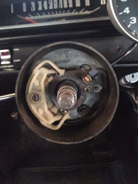

I just purchased an original '69 RR steering wheel and installed it. I currently have the motor out of the car and the power off. I turned the power on and the horn constantly beeps...
I disconnected the horn from the engine bay so that the power would stay on and tried to tinker with the steering wheel and its connections.After an hour same results. I've made the connection to the wheel and have seated it appropriately.
I see that in the upper right hand corner there is a plunger type of connection with a copper ball on top that presses down. I have no idea why I can't get the horn to function properly. IMG_1401.1.JPG

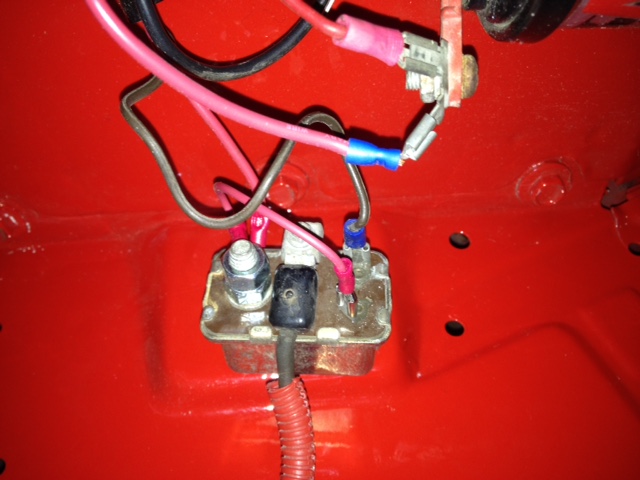

I just noticed that the horn relay is using a "starter relay" unit instead of a horn relay unit. According to Oreilly's there is a small difference in the relays, with the starter having another connection. Does this matter?
horn relay has 3 terminals, starter relay has 4 terminals for auto trans, 3 for manual trans....they are different relays.....auto part kids know nothing about cars...look it up online yourself and get the correct one

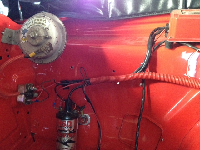

I took a few pics of how the car is "setup". This is how it ran when I bought the car.
For some reason the previous owner used a startup relay instead of the horn relay for the horn. There is another starter relay also on the firewall.
I'm going to hold off taking apart the column until I have the new startup relay to test. If it works then GREAT. If not then I'll purchase a horn relay and hopefully that will cure the constant horn issue. Then, I'll need to find out what the other two wires that went to the previous startup relay will need to be re-routed to.

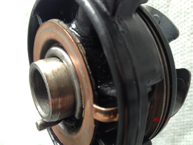

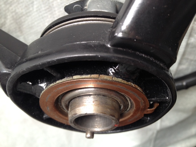

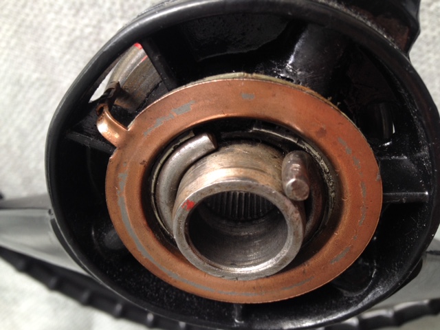

I've been reading up on the steering wheel horn contact. The contact under the wheel is old and may be bad...
Is there a way of removing the steel hook and replacing the caulking and plastic ring?
I've attached some pics for reference. IMG_1420[1].JPGIMG_1421[1].JPGIMG_1422[1].JPG
I had to do that to my old road runner because it was shorting out, the steel ring just pops out but make sure you mark the position and put it back in the exact same spot because that's what cancels your turn signals.
I just used some gasket material to make a new insulator and it worked fine.
440+6,
The steel ring is on there pretty good...Is there a tool or special way of taking it off? I've tried to move it but it won't budge and I don't want to break anything.
Also where did you find replacement parts; ie.e calking and plastic ring(s)?

I did this over 20 years ago but I remember just slowly prying it off, be careful and you should be able to work it off.
As far as the gaskets go I don't know who has them or if they are even available, but you can easily make them yourself with some sheet gasket material, that's what I did and it worked fine.
