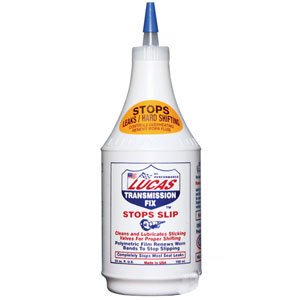

Morning all, having a slight problem with my transmission..Low miles (62,000) 1975 Fury I'm thinking its the 727. anyway.. its very jerky going into 3rd. at part throttle (easy throttle) and flairs as well going in to 3rd. part throttle to hard throttle (RPMs going up before it shifts into 3 rd.)
Is this a sticky valve body? and can I fix it with a can of stuff?

I know people that swear this stuff works.
HI I adjusted the linkage like the above link suggested. Tho its not hooked to the carb I locked it in place for idle.. It shifts much better now with no jerking going into 3rd but it does still have a slight flair (raise in RPM before going into 3rd.) at easy throttle. I might try to add a little more rearward setting and see what that does and maybe some of the Lucas stop slip.. I think its just a friction modifier but it might help for the mean time..
