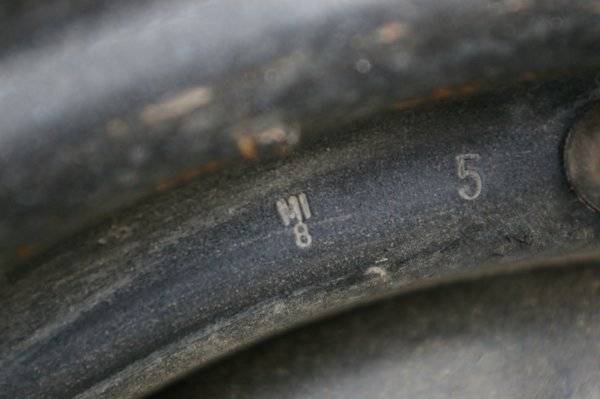

Thanks, I just spent 20 minutes looking at the rims I have in the garage lol. No date codes other than a "5" and "0", sorry Justin.

no look up table for steelies....just in my head from years of searching and examples I made from picture. Very few references...
I just gave you the date code format...just decipher the numbers off my previous post. Some have date stampings in the lug area as well. Diameters are stamped on the inside of the rim also.

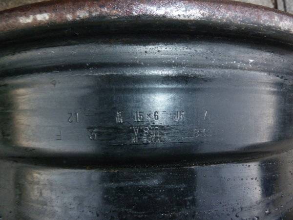

I've found this decoding of rims interesting. I've included a couple shots of one stock wheel from my '68 Coronet Deluxe built on May 31, 1968.
If I read the stampings correctly I come up with a 5" wide Motor Wheel produced May 11, 1968. Is this correct?

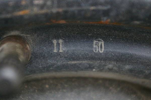

left side of the valve stem K23 5 then on the right of the stem is 13 675. Guess I'm dense because I'm still not able to decipher them....done too much of this over the years :BangHead:
Thanks....but I can see where the 5 and the 13 come from but is the 23 for 1973? Is the 675 a part number?
The 2 is for shift from what I have seen...without seeing the rim face I assume it is a later time hence 3 for 73....you guys have to post pics....if there is just 3 dimples to hold the hubcaps then I would say 63.....without pics we are guessing...
