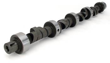

Looking to replace the lumpy camshaft in my 440 with a stock camshaft.
Mancini has a Comp Cam kit for $252.00 while the MP kit is a hundred thirty bucks more.
Thoughts on which to go with?

Mark I used a comp cam 268 high energy cam in my 440 car back in the day. Stock smooth idle and tons of torque. For some reason I thought someone was making stock spec cams for the 440 magnums, but I can't remember who it was at the moment. CRS
High Energy™ 268H; 1200 - 5200 RPM Range
Product Representation: Actual part may vary based on configuration ordered.
Part: 21-215-4
Price: $154.09
Weight: 10.08 lbs FREE SHIPPING OVER $50!
Quantity:
HYDRAULIC • Great Replacement for 383 Magnum w/ 650-750 CFM Carb, Dual Plane Manifold, etc • Smooth Idle 440 w/ Super Torque
Lunati Factory Performance Cam and Lifter Kits 10211005LK
Cam and Lifters, Hydraulic Flat Tappet, Advertised Duration 278/288, Lift .455/.470, Chrysler, Big Block, Kit $254.99

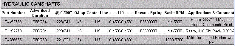

Dave is that p1152270 still good or is it the long discontinued low taper grind that took the flatter radius lifters
anyway that is the spec for the later HP cam
The 268/284 is in MOPAR degrees- around .008 (compare with ENGLE) Exhaust is over 300 CRANE .004 degrees it's like a 280 class Comp .006 cam
designed that way to not click and clack till after warranty and easy on the valve springs
Sorry wyrmrider, it's lousy picture quality. It is actually P4452270.
Lol, if you look down the line under "application" it looks like "110 Six Pack".
What cam is in the car now other than one that's lumpy??
Is that 228/241 accurate? At a true .050? Seems kinda radical although that is what Summit lists as the restoration cam for a Roadrunner.
Doesn't sound right. I had a 509 cam, 242 at .050, and it was way more radical than the stock Magnum cam.
