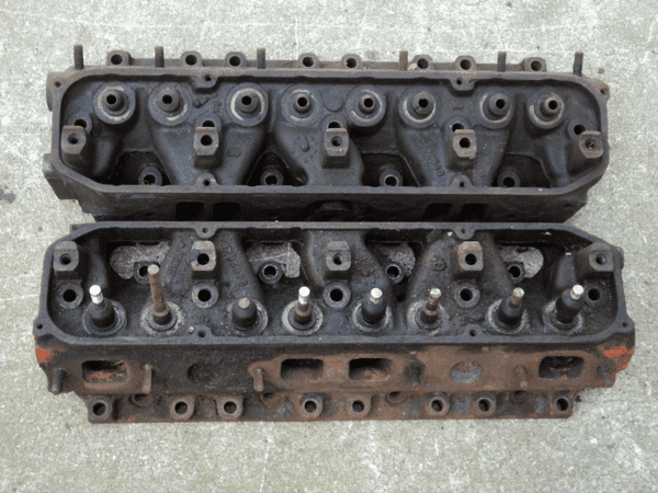

I've seen stock iron heads that have "wide" rocker stands (top pic) & "narrow, machined" rocker stands (bottom pick).
1. Do any year stock rockers/shafts fit on either style of rocker stands?
2. What are some decent quality aftermarket, stock-style rockers that aren't too expensive?

So, I wonder why the rocker shaft stands were changed by Chrysler? I know I had to file the center stand and the inside of the outer stands so Isky ductile iron rockers would fit. (71 heads) I'm pretty sure I wouldn't have had to file the stands on heads that are "already filed", so to speak, like my top picture. I've seen many stock heads over the years both ways, but never figured out which ones have the machined stands & which ones were not machined or ever heard why.
I couldn't say why the differences. Some speculation could be worn or damaged casting molds? An issue with stands breaking? Different suppliers? Further back ('62ish?) I guess there was flats on the heads for the rocker shaft supports to bolt on.
