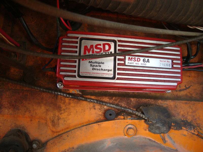

I've had good luck for MANY years with a stock Mopar electronic ignition distributor & a MSD-6A ignition box. I can't say the MSD is any better than the Mopar orange box I had before it, but it sure has lasted longer.

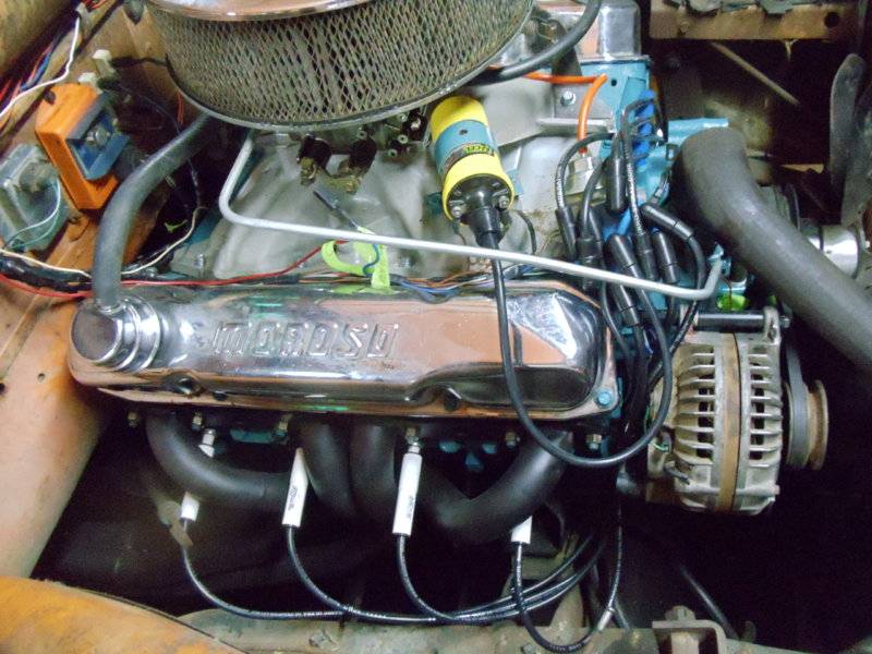

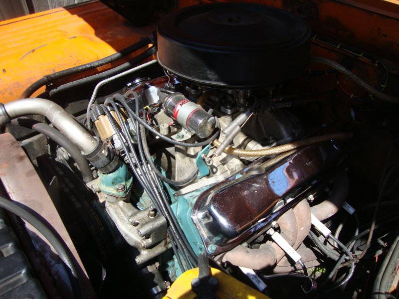

i'm using a mopar performance dizzy with a msd 6a unit on my hp 383 with good results . and a stock type mopar electronic dizzy and box on my stockish 440 with good results . both are street hotrods . the 63 maxwedge car has a mopar race dizzy with a 6al , it works great .
I’ve got the same setup as lewtot, never had any problems with it.
