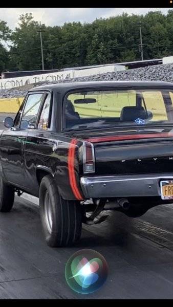

Note on the pic the body separation and tire being driven into the track.
