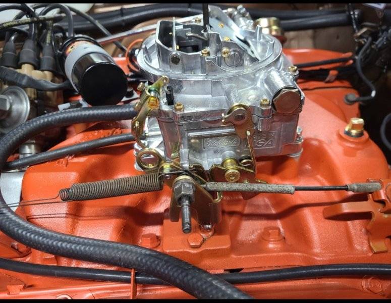

Here's mine.
Old Carter AFB replacement
Edelbrock fitting
What's going on:
Broke the motor in with one of my Q jets. No problem. Wanted to use a "known good" carb. (See picture at above link)
Then I figured I'd buy my first ever new carb.
800 CFM. Why not?
I might put it on a bigger engine later. I just want to get down the road.
New engine deserves new carb.
383 mild cam. 3/8 line to stock fuel pump and 5/16 line to carb.
Now, set the idle speed and crack the throttle. Engine will not return to idle speed when throttle goes back to idle. Stays high.
No linkage binding. I'm doing if from the linkage watching the plates. Not on fast idle cam. Looked down carb don't see gas peeing.
Adjust idle screw to slow it down and the engine slows down and dies.
(The plates are closing more then when I set it down than when I initially set the idle speed.)
HUH?
Did I buy too big a carb? Can't be a fuel line delivery flow problem?
I've played with the idle mixture and doesn't help the problem.

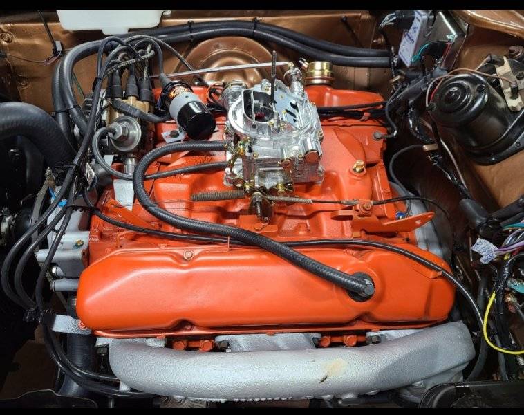

Here it is today. I'll make it pretty later...if it ever works right.

Do note the picture in my links above of the actual carb.
What everyone is showing on the net is a spread bore carb.
Which is what I really wanted. But I knew the pictures were wrong going in.

looks like you moved the accelerator pump to the top hole Sometimes you have to bend the arm a little so it is not binding.
The pumps is where ever they sent it.
