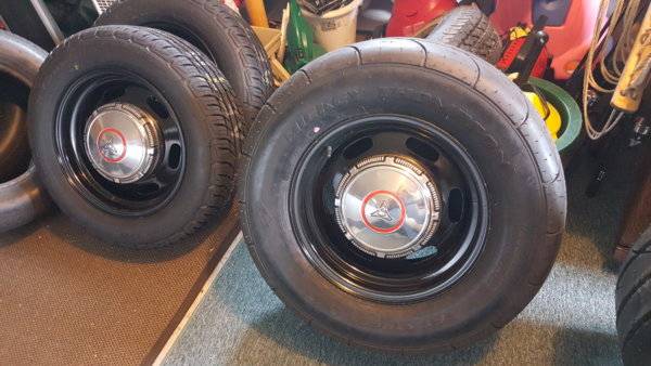

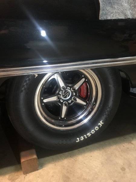

This thread is relevant to my interests!! Does anyone have experience with Hoosier DOT drag radials? Looking at a set in 275/60 15 ......https://www.summitracing.com/parts/hoo-17317/overview/
I have them, unfortunately no road experience with them yet....

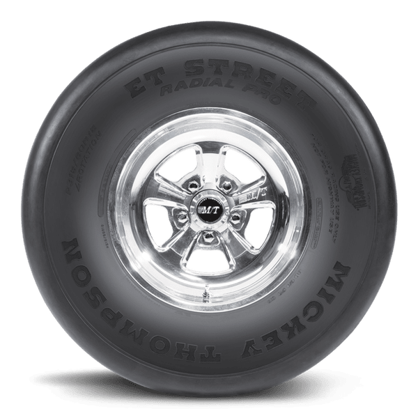

I'm running the M/T Radial Pro and I love them, on a trans brake leaving at 3000 on the street almost zero spinning @ 16 PSI .

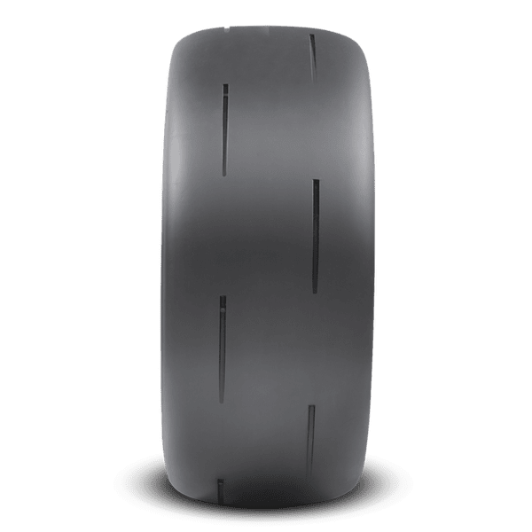

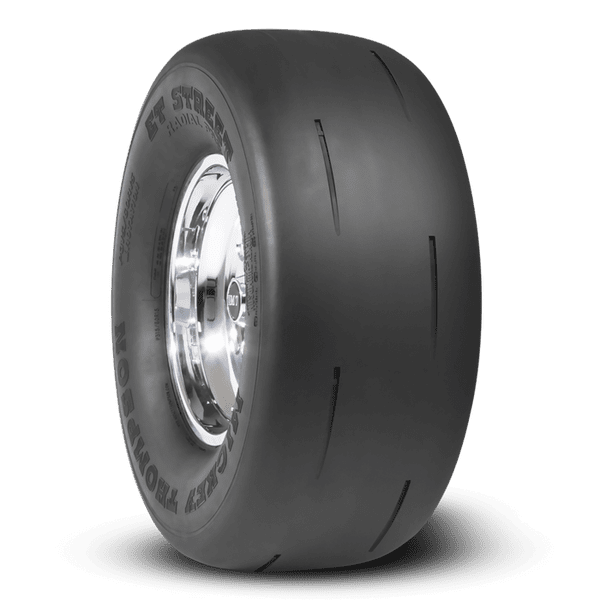

There are already some good recommendations here, but I would ask how many miles do you drive per year? If you want something that is a little more "street" and a little less "track" but still provides good hook, I'd take a look at these from M&H or these from Mickey Thompson. I'm a little bias toward M&H because they always given me good performance and the guys over there are awesome. Shoot them a call or e-mail they can help you get it dialed in how you'd like. Having said that...a lot of my buddies swear by MT and I don't have anything bad to say about them.

I'm running the 315/61/15 radial pro on the street and this bitch hooks nice !! Trans break & 700 horse power to the ground straight as an arrow, with little tire spin !! street race this car almost every weekend !
Mickey Thompson ET Street S/S work great for me on the street.
