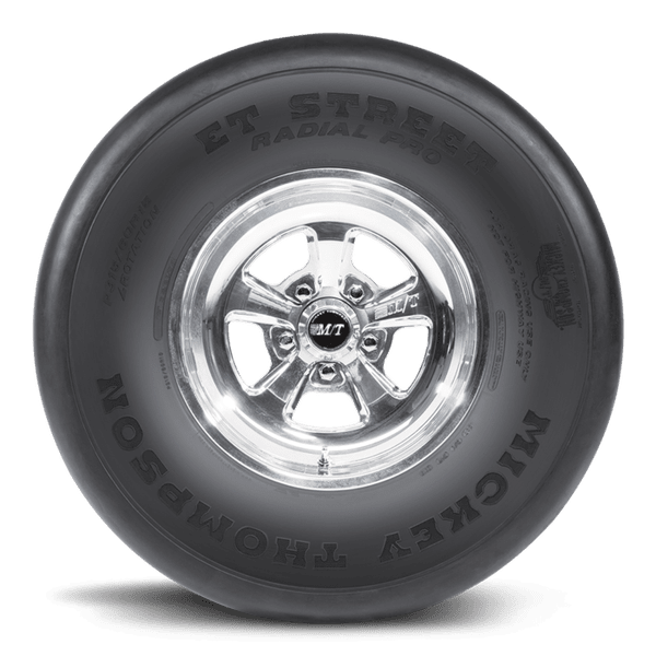

whats the specs on those rims/tire combos in this pic?
tire brand/size, wheel brand, backspacing, etc. would be helpful.

They are 255 60R15 Mickey Thompson ET Street S/S on 7" stock cop wheels. They fit well on my 66 Coronet 500.
I'm also running these - 255 60 ET street. A huge improvement over the larger street tires I had. I like the size better. They don't work when wet and I do not know how they would work if I really pushed a corner, but that isn't what I've been doing.

what is the wheel size and back space. your car looks great
Thanks, they’re 15x7 with 4.5”bs. There’s room for more backspacing, another inch or so. I had some 15x8 with 5.5” bs that would’ve worked but the step inside the wheel wouldn’t clear the wilwood caliper, 15x7 cleared
