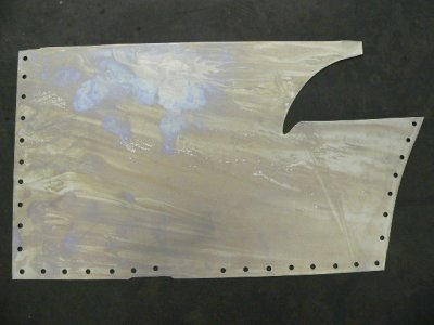

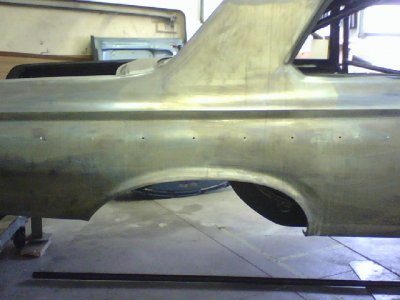

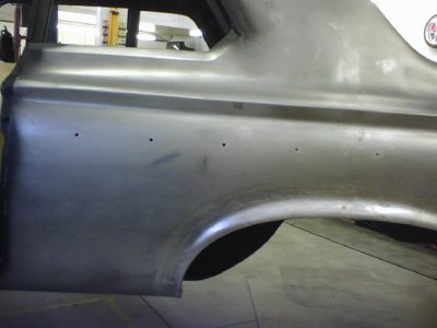

I use it without problem. Tape off seams and crevices. Wash of with soap water and red Scotch Brite. Then Scotch Brite and Metal Prep. If you keep it dry it'll stay rust free for months. You can always reprep right before Epoxy prime. Remember Epoxy needs to be scuffed if it sits over 48 hours. Here's some pics of Metal Preped panels tat sat for months.

I was looking in to media blasting but what i'm reading, unless u live in texas and have access to donny, i'm not willing to risk it. i have no time issues so what the heck. appreciate the input.
looks good dvw. i think this is the route i'm going with, any type of epoxy u reccomend.
