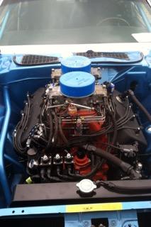

I have a 4.250 crank with 7.100 rods in my 528" Hemi. I am also running a 10 quart flat bottom top fuel/funny car pan. It doesn't hang any lower then my 2" deeper trans pan.

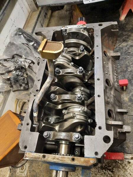

We are using a early 72 230 block as it has more clearance and has thicker mains. I dont believe all 230s are the same and 76 would be different yet for clearancing. Ours had enough room for the larger rb counterbalances to fit with only the crank itself barely hitting in 3 places at the flat bottom area of the waterjacket. ALL the rods require a notch at the bottom of the bore and the biggest interference is the oil pickup and pickup tube itself...it is why most do a external pickup. We made 1/2"internal tube fit after a considerable effort.
A '76 block "should" have a rib that makes contact with a rb counterbalance, its easiest to get it 2 clear by keeping with a b style crank counterbalance.
Their is no stroker "kit" available to put the 4.5" into a B. You have assemble the pieces. We are using a bryant billet crank that we turned the rods down to BBC 2.2" and mains turned down to B, but RB counterbalances. H beam scat rods, icon pistons and thick stackable cometic gaskets to lower the compression.
The 4.25 is a much easier combo and runs really hard. They also make a 4.375" which you may want to consider. Your welcome to send a pm if you want more details. Picture is our 542 b with internal pickup, when we were assembling it. Doing a 542 is not for everyone, it's all custom.
