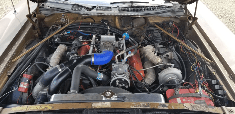

Just a TWIN TURBO EFI? Haha. Something probably worth mentioning. Doesn't the oil go through the turbos and get real hot?
A high volume pump at 60psi does not pump any more oil volume to the motor than a standard pump at 60 psi.
The setup has been running since 2012, I did a small upgrade with this engine in 2022. Old engine was fine with the turbos.

Show us some pictures of the twin turbo efi set-up, please.
