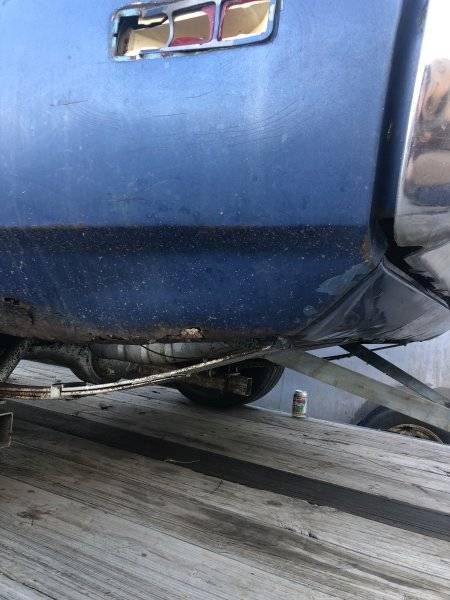

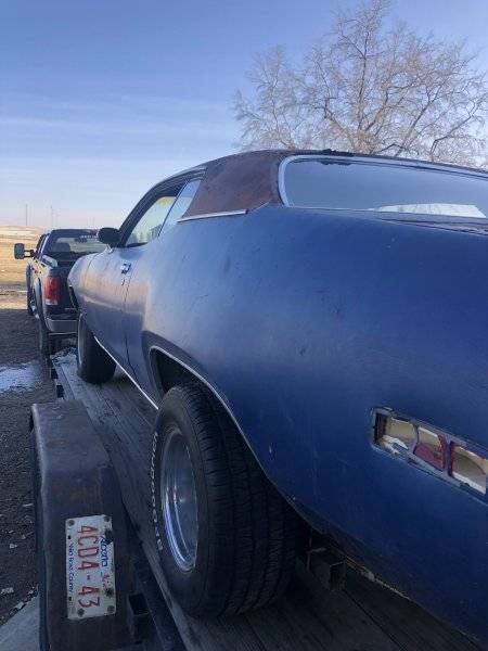

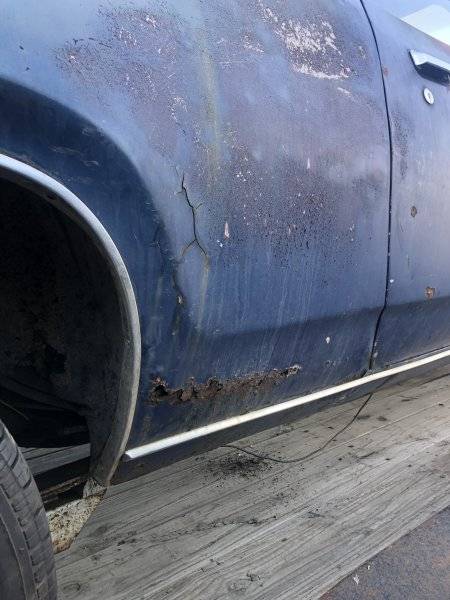

After weeks of waiting patiently, sort of, StuBBle has left the field. I chose his name because aside from that being the first pic I saw, I’m pretty sure the last days as a driver were as a stubble jumper! Pretty great shape over all. Fairly straight. Less than typical rust. But the floor has some indicators, along with one dented frame rail, that it had some fun times! I’m pretty happy with the car, and surprisingly so is the wife!

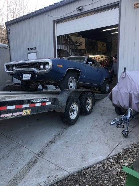

The fellow I got it from is an excellent fellow. He has some really nice 860hp aluminum hemi cars and a beautiful shop. So a couple beers later, and looking at a bunch of cool stuff, we loaded Stubble up and headed home. I could have spent hours visiting.....I plan on it some day!
Tonight I got him into his new home. The goal is to convert a pretty basic Sebring and clone it into a GTX. I got a parts car with A/C, power windows, floor shift column, the shifter and the mounts for that. We’ll see how far we go. Pondering 440 / 4 speed, but auto would be way easier, and I have all that.
He may have had some race history as there are a few stickers indicating performance.
The license plate on it says 1989 so it has been off the road for a while and potentially only lived on the road for 18 years.

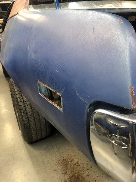

A little play time this evening straightening up a couple little spots.
He definitely lost the battle to a couple fence posts. Lightly though. A few minutes with a hammer and 4 spots are looking better!

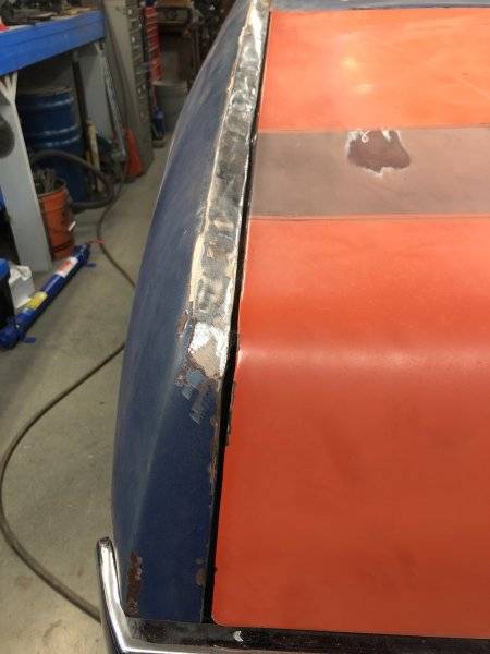

Something fell on the roof and trunk of Stubble at some point in his life. The trunk lid was damaged beyond worth. But the parts car had a great one. No rust. Just some wrongly drilled holes from a wing. Fits pretty good for an hours worth of body work. The drivers quarter will need to be massaged outward an 1/8 or so, but it’s already better than pushing it all down like they did in the past.
I love making a car whole again!
I pushed the quarter out with the porta-power. I can't believe they didn't do this on the original repair. Instead they mashed the trunk lid and pushed the damage in so they could bondo it. Shadows are deceiving, the deck lid is perfect. It will still need some putty because it has been too repaired in the past. We'll see, I may take the uni-spotter / stud puller to it tomorrow and get those couple of dips. If I was to do a full quarter it would be perfect. I’m ok with a 50 year old car having a smidge of repair work on it.
