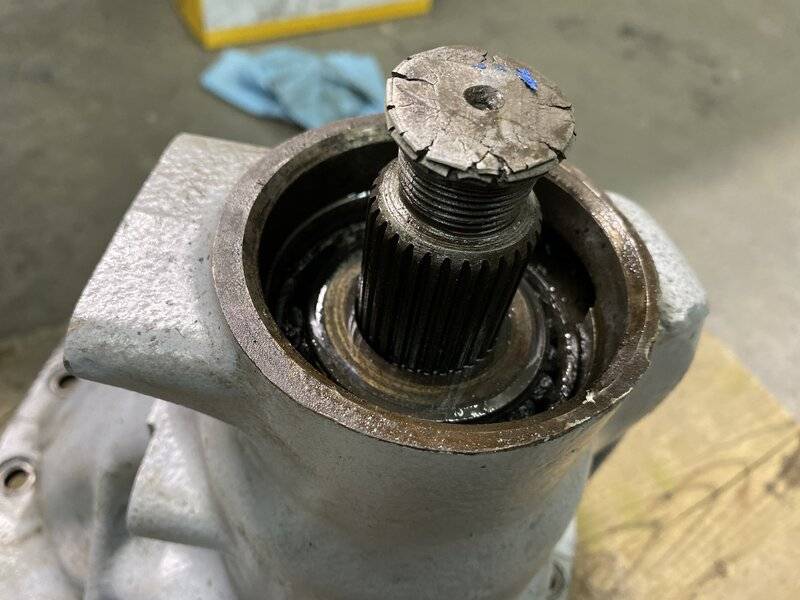

i got the yoke off without too much of a problem. It seems as though the pinion bearing and pinion are fused. Can’t seem to push or hammer it out. I put some penetrating fluid on for over night. Will send pics of where things are at for more ideas.

you got that right!! Check this out. Hoping to use oxy acetylene this weekend - cause this thing ain’t coming out another way
If your going in with a torch you might try cutting the lip of the inner race and pulling the rollers out one by one, then the inner race might drop through the outer race opening. I dont know the dimensions of the races but it's what I'd try first, surgical approach before the all out molten steel option.
