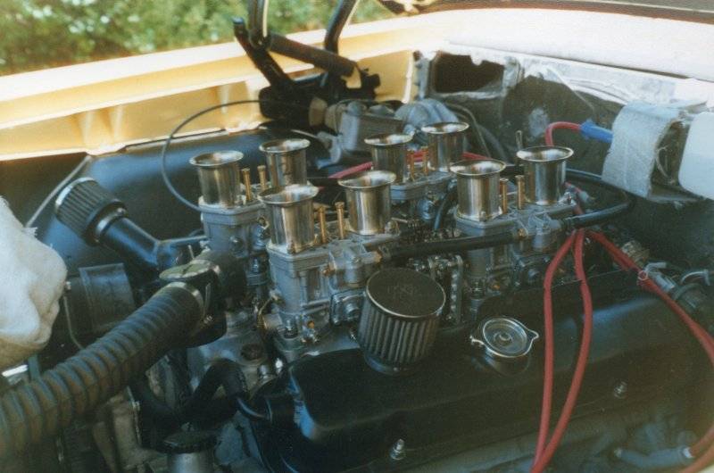

My current car has four downdraft Weber carbs on it, street driven, the only one in the world that I am aware of. The only one because there was never a dedicated Weber intake made for this engine. Do you think getting those tuned is done with zero carb tuning knowledge?
