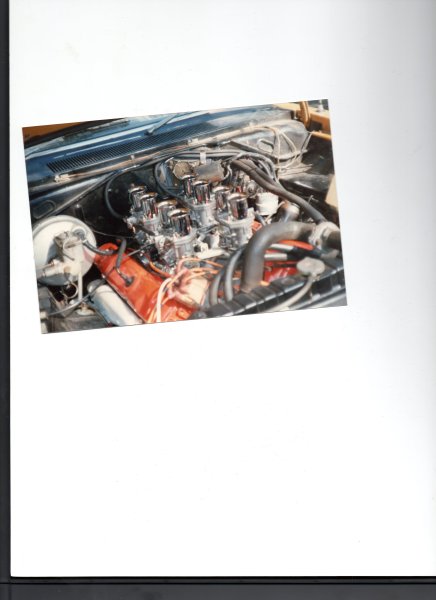

I have tuned more Holleys than you have had hot dinners.
That is when/how I found out that there are better carbs out there.....& they are NOT Holleys.
My current car has four downdraft Weber carbs on it, street driven, the only one in the world that I am aware of. The only one because there was never a dedicated Weber intake made for this engine. Do you think getting those tuned is done with zero carb tuning knowledge?
As for credibility/advice, I have people thanking me publicly & via PMs for my advice.
I say it how it is [ others do not like to ] because I really do not care what people think, so get used to it.
