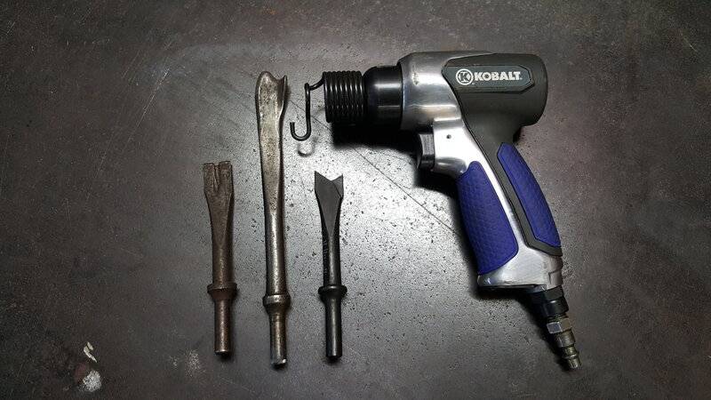

I usually did the chisel & hammer method with some heat to remove mufflers, a lot of elbow grease and scraped fingers with systems having the U-clamps. After cutting the slot every inch or so inserted a large screw driver to separate the pipe. Not the best or easiest; but did the job in the garage or driveway. I removed my couple hundred mile old 2" exhaust system during poly motor rebuild going to headers and 3" by cutting the pipes ahead of the axle and dropping from the manifolds keeping the system intact able to be re-welded with a sleeve thinking of possibly of reusing someday. As it is I'm going to sell it when I get around to it. In any case, having the nifty tools to do this as posted is what I'd a liked to have back when...
