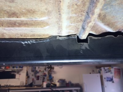

Good morning gentlemen. I am a very junior member here just asking for feedback. Have read previously of US Cartool and their sub frame connectors and how well they worked. I ordered a set for my '69 Coronet and started the prep work for getting them in place. I have to say I was pretty dissapointed in what I got after the initial fit up. I spent almost 5 hours in grinding just to get them where they would fit enough to weld. In some places I had 3/8" of material to take out of them just to get less than 1/8" of standoff, seems they weren't even made for my car? There seemed to be bumps and high places that didn't belong at all on these pieces that had to be completely removed. I was a welder for over 20 years and did years of layout work for fabrication so the quality of what I got was less than satisfactory. My car is original, unwrecked and pretty pristine underneath so i have eliminated anomolies in the car from outside sources...factory differences might be the only variable.
I just wondered if anyone else had this type of experience or is that normal for US Cartool quality? I don't know whether to go back to them for confirmation that they sent the corrct parts or just let it go as another dissapointing aspect of buying retro-fit parts for these old cars. Thanks for any info or opinions you might have. Mocajava

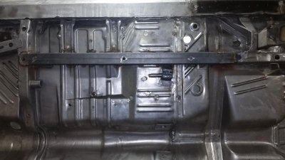

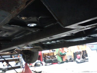

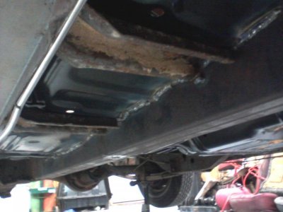

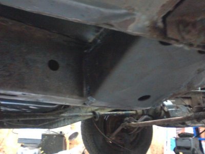

I installed them on my 66' Satellite along with torque boxes. The installation went fairly well without to many snags.
Driver rear box.jpgDriver sub connector.jpgpassenger front torque box.jpgpassenger sub frame connector.jpg

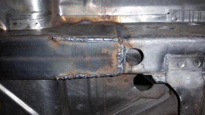

I put some on a 68 charger, spent several hours customizing they were also to wide in the back, have to cut each side and taper them. i ground the welds on the front so they were square and looked like factory, if i would have looked closer i should have square cut the front flanges so it matched the stock ones net to it20150322_114655.jpg20150322_114625.jpg20150404_172017.jpg
You guys are good. To the untrained non-Mopar eye, they look factory.
I totally agree, that is some beautiful work! The gaps I HAD were almost 3/8" and the comment of using jacks to move the floor will be tried. Thanks all!

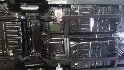

Well the connectors are in! I have a 4 post lift, made it easy and safe. Used the hyd jacks underneath to coax the gap closer. Skipped around, beat floor down in places and got it done. Next step is the POR15 ritual, multiple steps and preperation to do it right from ALL I have read. Since I have bare metal as well as the rusty stuff, a little different technique is required...scuffing up the bare with coarse sandpaper and metal prep to etch it.
I will get some pictures up of the steps and try and keep you all updated as I ease thru it. Last thing I want to do is miss a step and end of with peeling POR15....read that has happened to some. Shoot darts at me if you think I am going down the wrong road...I can take a shot, been Married three times!
To all of you who have installed these: did you solid weld them or spot weld them? I'm seeing a lot of continual welds in these photos.
I'm guessing solid welds could crack? Spot welds every 1/4" or so would be just as solid and "give" enough to not crack? Factory like.
its not necessary to weld them solid, but it is easy to get carried away
Tacked every foot or so and then skip welded about a 1 1/2" segment all the way, moving all around to let it cool/contract. Took me two afternoons of welding to finally get it all stitched up end-to-end. Hit it with a small hand grinder to knock off the high spots and smooth it a little. Ready to start the POR15 process. Thanks for all the helpful suggestions.
