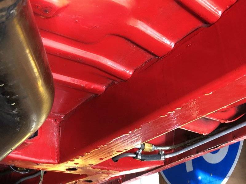

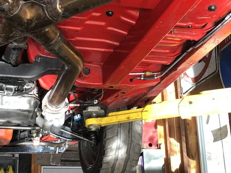

I made my own 3 x 3" subframe connectors and while they are not welded to the floor pans, I used seam sealer to close the gaps to make them look like they are. I did this in 2012. As of today, none of those sections of sealer have pulled away or started to crack. This tells me that either my doubts about the value of "welded to the floor pan" have merit or that I'm not driving my car hard enough to stress the chassis.

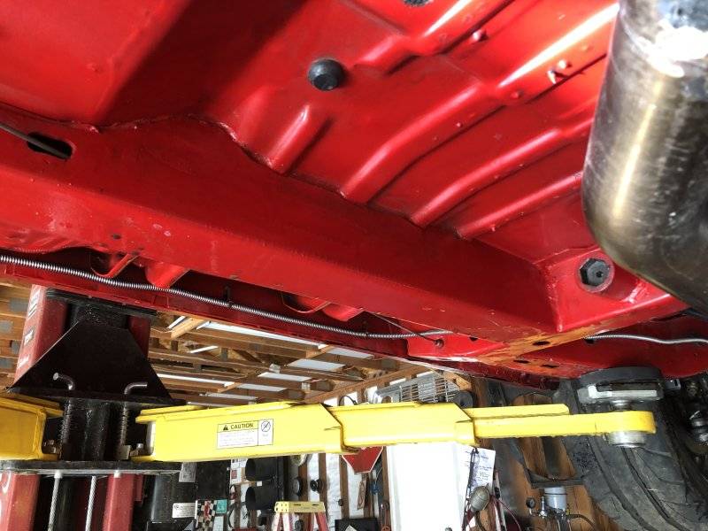

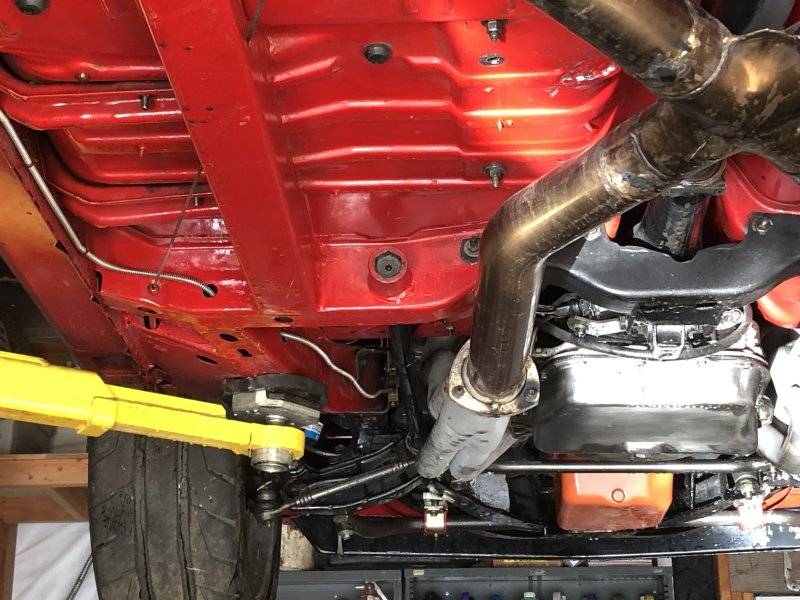

A few years ago I had the car on the lift and I cleaned up the underbody for these shots.
It still looks about the same today, though a bit dirtier.
The goal for me was to make it look like something the factory could have done.
Funny...I look at this and see the automatic transmission and am glad that I made the switch to the 5 speed.

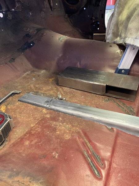

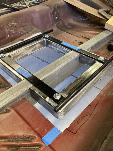

When I put mine in, I ran them through the t-bar x-member and into the front rail about 5". The back was extended to go past the current front spring hanger boss. That was done so I can weld the spring relocation box to the SFC's. On top of that, I made additional frames for the seats, will be Procar units, to attach to instead of relying on sheetmetal.
On the existing rails, I slit them vertically, punched holes in the side and lower walls, pulled them onto the SFC's with clamps/weld Vice Grips, made a bunch of rosette welds plus lap welds to stick all together. The t-bar unit also got material added on three sides to stiffen it up for the bigger bars.
