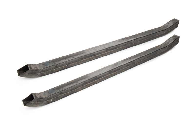

Has anyone used or even heard of them (Chassis Engineering subframe connectors)?
Several vendors on ebay but they have a webpage as well (with lower prices): C/E3651 -68-76 B-Body
They are of the weld-in type but only front and back (2x2").
Purchase a 20' length of 2x2x? and have enough for 2 cars for less money. Cut them into the floor and incorporate the floor into the structure for more rigidity.

Yes it makes the floor part of the stiffening process, but the floor already is part of the stiffening process and it's not stiff enough and that is why one most likely is adding subframe connectors in the first place.
Now it you are ok with adding a SFC that only has three sides, USCT is your choice.
Regarding 2x2 material, IMO that is a stiffer solution than the 3 sided reduced cross section USCT option.
If one is looking for stiffness AND willing to cut the floor, 2x3 is a much better choice.
Any SFC with a bend or reduction size in any dimension, is less stiff than one that is larger or has no bends..

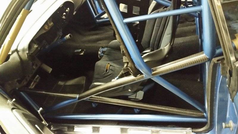

2x2 will help some, but 2×3 through the floors and welded 100% would be much stronger. Mine are c.m. round tubing tieing the sub-frame and into the roll cage as well.

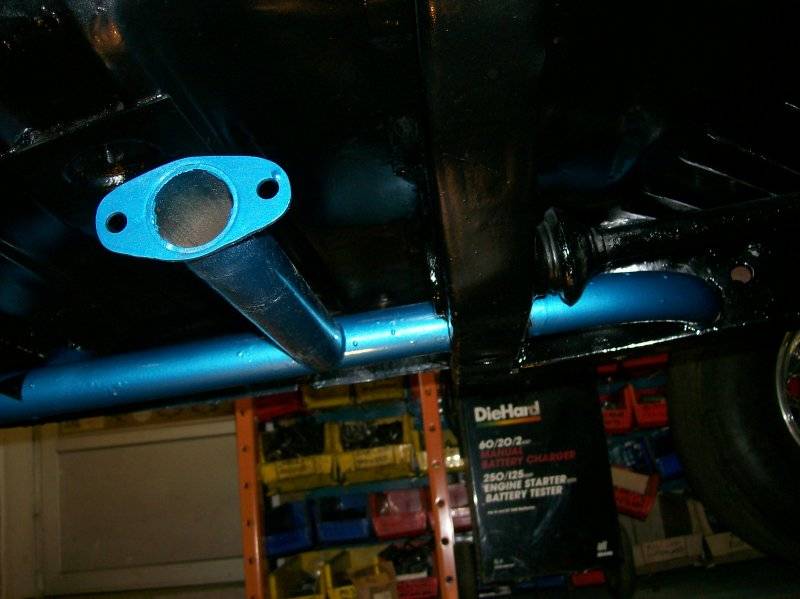

2×3 rectangular tube, set it back into the rear rails till you can see the tube in holes to weld then half and half cross it with torsion bar cross member and continue on to attach to front rail at a angle. I call them Birdsong connecters, as I learned of them from his YouTube video. These are intrusive in the rear floor pans and under the seat, so a high value number match car I would just put U.S. Cartool connecters in.
