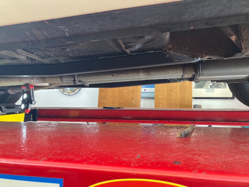

Started as bolt on frame connectors that I modified and tucked in at the back to look proper. I also added the front and rear torque boxes.

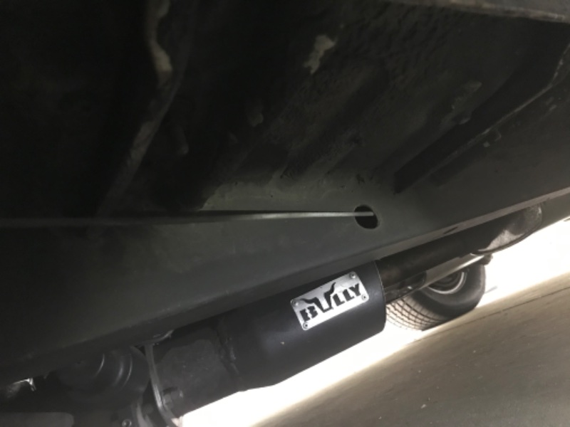

2” sq steel tubing cut and welded into the subframes really help with the car feeling more solid, handling and even the doors and windows fit better.
My frame connectors are c.m. round tube and go through the torsion bar cross member and tie into the front frame rails and then go up to the inner rocker panels diagonally and then my A pillar bars come down through the floor and tie into the diagonal bars in the second photo. The frame connectors also incorporates a removable for transmission maintenance drive shaft loop.
