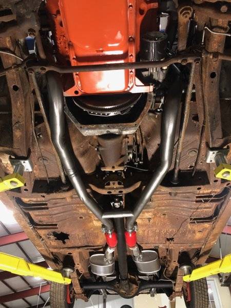

Some Imperials have small mufflers/resonators ahead of the regular muffler and Imperials have 440's and are very quiet. I took note of that and put 12" glass packs in front of the turbo mufflers in my '70 Roadrunner. I like the way it sounds now, but if I ever want it more quiet, I can still put resonators on the tailpipes too.

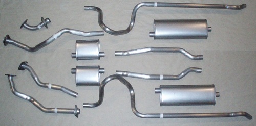

Top pic is Waldron exhaust for 1962-66 Imperial.
It has been done the other way, and I suspect the Imperials were the way you mention mainly because that was the easiest solution for OEM space wise as others have noted. My goal would be the best configuration, and what that is has yet to be proven. Adding a third would likely get you close. :thumbsup:

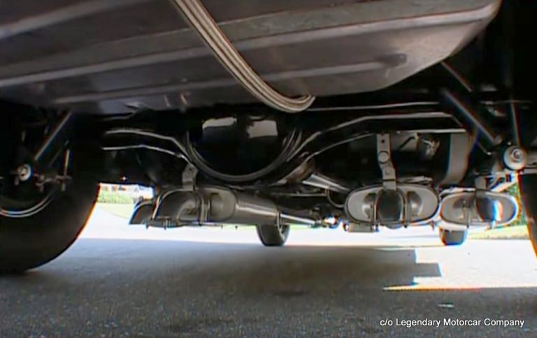

The picture above of Jimmy Addison's "Silver Bullet" is a modern interpretation of what was originally (back in the 60's) four Imperial mufflers....

Jimmy's Bullet allegedly had four Cadillac mufflers. Imperial mufflers I suspect would do the same job.
