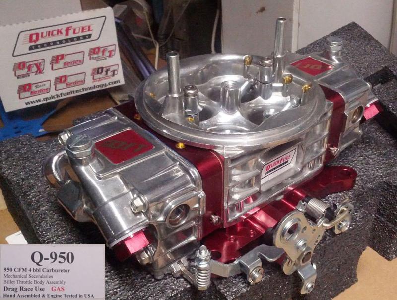

Quick Fuel is built better, but i would easily use a Holley 950 and be just as happy. I would stay away from Edelbrock or Demon.
