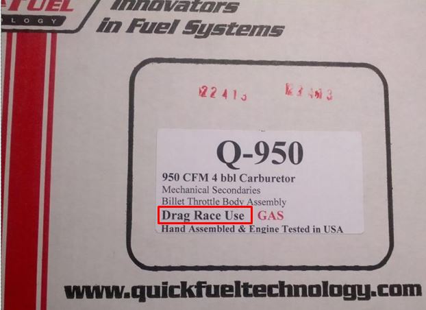

I am not an engine guy so I followed and experts advice (IQ52) based on his engine dyno tests, cylinder head flow data, and A/F ratios.
I did ask the question and the answer was QF950.
It says, right on the box: "Fer Racin"
Well if it says "FER RACIN'" Then it's the right one!!!
