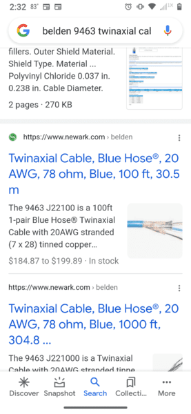

Thanks Don, after doing some research I did what you suggested with some foil and a drain wire wrapped in electrical tape and heat shrink. It worked thanks again.
I have a bunch of 9463 let me know if you would like some.
