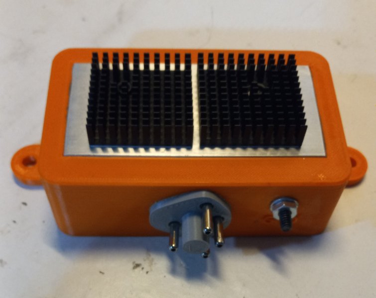

Some discussion with some fellow members brought on one more design.

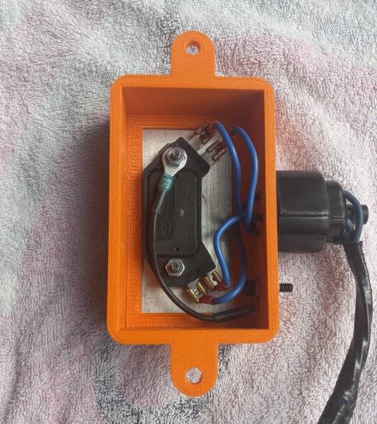

For those looking for more "stealth" or cleaner look. This latest design completely covers HEI module itself and resembles more of a typical ECU box.

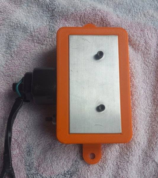

This design uses a 2x4" 1/8 baseplate of alumium with 2 - 40 x 40 x 10 mm heatsinks on top to ensure no over heating problems .
The two Allen head screws are threaded into the alumium plate to provide very sturdy mounting points for the module.

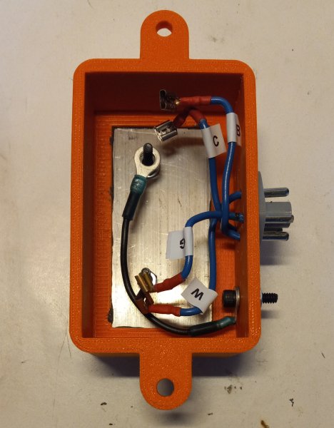

A grouding post is located beside the OEM plug to keep wires nice and neat.
Underside , wires are labeled for hei module pins.

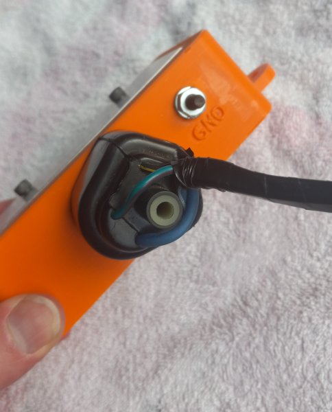

This design is slightly more difficult to do the initial mounting of the module inside the box but once it's installed it will provided a nice clean look to be mounted where ever you like.
The main take away from all my designs is the ease of install, using the factory oem plug.

Looking good. For best thermal transfer from the aluminum plate to the heatsink, for the final revision, you'll want to polish that aluminum plate to a mirror finish on the outer surface. :)
