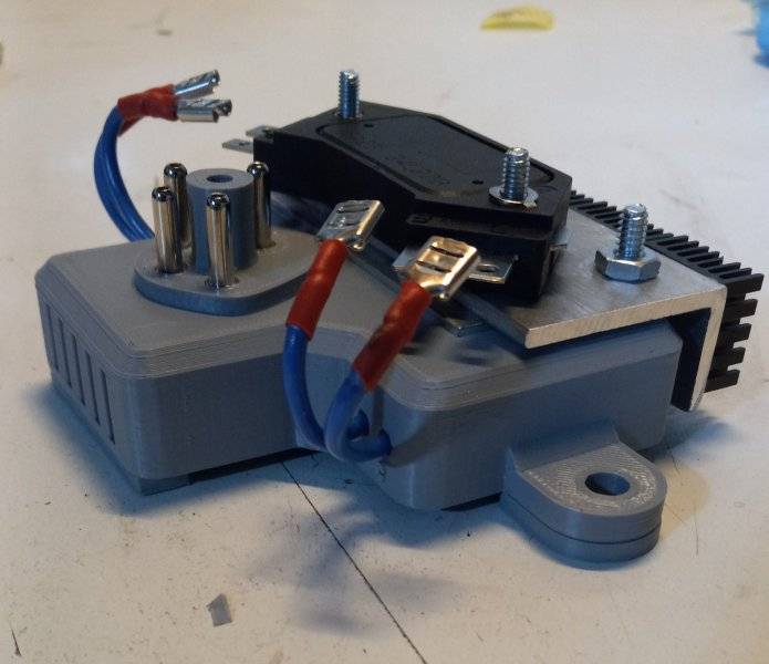

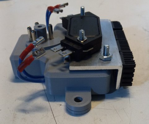

Im still playing with my mount trying to perfect it. Those little HEI module create alot of heat ! . As another member wrote in his own thread , my original design was lacking enough heat sink. His solution was the AC delco heat sink ADDED to mine which has been working great from my understanding.

For any that have been flowing this and other threads in this forum about that HEI conversions. I have modified my original design slightly to ensure that the module is kept at an acceptable temperature.
Modifications
1. More venting was added to allow for air to completely past threw the entire mount. This will aid in actual "air flow" where there is actually a path for air movement from one end of the mount to the other.
2. Doubled up on aluminum plates . There is now 1/4" of aluminum plate
3. Added additional heat sinks to the backside of the mount. With the added venting this will allow for quick heat dissipation.
Keep in mind, if the correct parts are not installed it doesn't matter how big your heat sink is, you will cook your module. Another member here @zombezoo has an excellent thread that went threw some problem solving of the HEI setup. It also point out how important it is to have the correct ignition coil for the setup !!

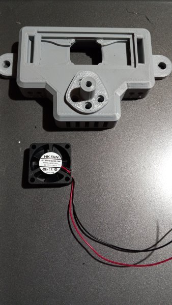

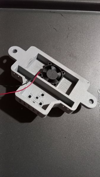

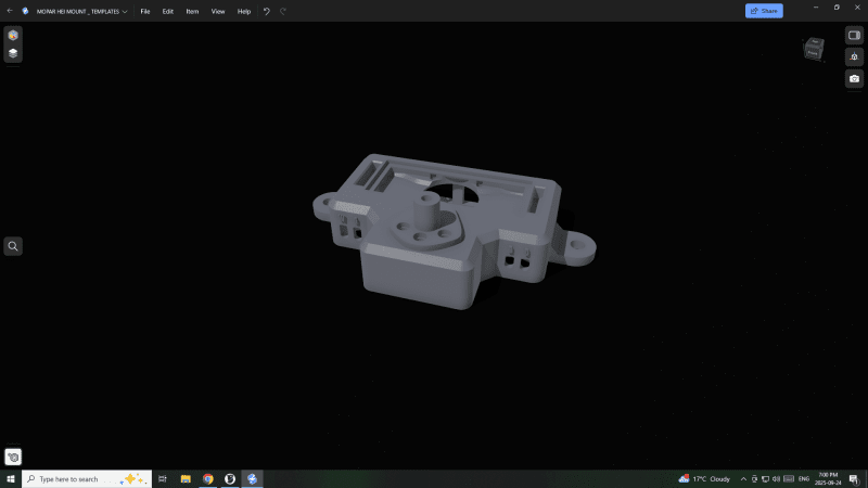

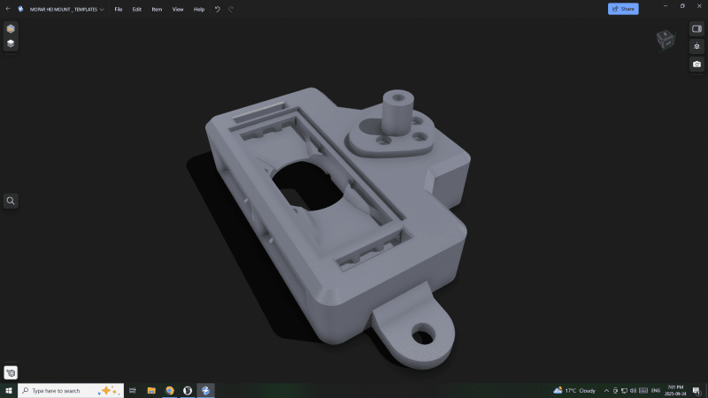

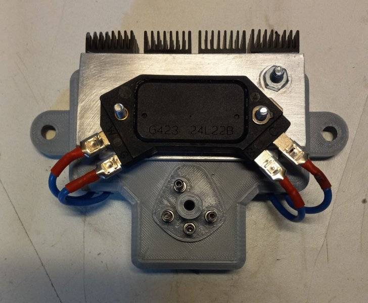

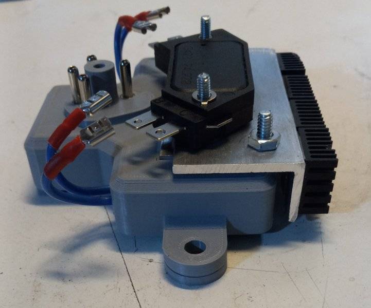

This little project has become a little obsession of mine. And have made some major updates to my design
My original design lacked enough heat sink, as discussed. Other members had found that adding an AC Delco heat sink to my design was enough to solve the problem and most would be happy with that.
I gave myself a high school lesson on heat absorption and dissipation and went at improving my setup.
What I learned is that for constant heat disappation, you want to have as much surface area as possible. My previous attempt at simply adding mass to the design was not the right approach.
My new design has added considerable more surface area , thanks to 4 finned heat sinks , and addition of 1/8 piece of 90* aluminum. Also added spacers to lift the entire mount up to allow full airflow under it. Other tiny tweaks here and there.
Something else I learned that is unique to my specific setup is air flow. Most cars will have a large amount of of under hood air flow, thanks to the factory style mechanical fan. In my case though I am running dual electric fans. My setup is dual 12" fans housed in a completely sealed shroud to my rad. Although this does an excellent job of cooling the engine , it does not create much under hood air flow. Even when the fans are running , most air flow is directly towards the engine block. Again great at doing what its ment to do, but really cuts down on under hood air flow. Especially something mounted on the fire wall.

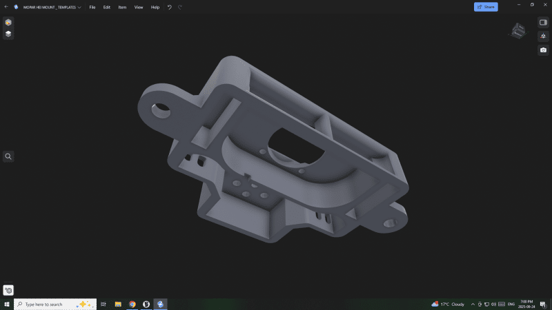

Trying to problem solve this for my set up, i was able to add a small 30mm fan inside my design . I created a duct system that send air flow over the entire backside of the heatsink. It's then direct up both sides and blows on the upper part of heat sink as well. The added air movement is key as it greatly improves the heat disappation. This design is slightly different from the original , as trying control the flow of air to and from the fan.
The little fan draws an almost unnoticeable .1 amp but moves about 4cfm of air . It's powered off the same wire that powers the module. No additional wiring needed.
I now have 2 designs .
1. Original design with upgraded heat sink which will be suitable for most cars.
2. Original design with added fan and duct work.
Some pictures of design without fan, as well as some proto type of fan design and 3D renderings.
Enjoy !
1000007676.jpg1000007675.jpg1000007674.jpg1000007678.jpg1000007679.jpgScreenshot (17).pngScreenshot (14).pngScreenshot (19).png

Glad you are happy with your new set up but I think it is overkill.

I do think the heat sink should be a little thicker 1/8-3/16" for peace of mind....

Yes, 1/8-3/16" thick but does not need to be finned. Can just be scrap alum that you have on hand.

Thanks, I would rather be on the side of overkill than not enough.
