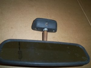

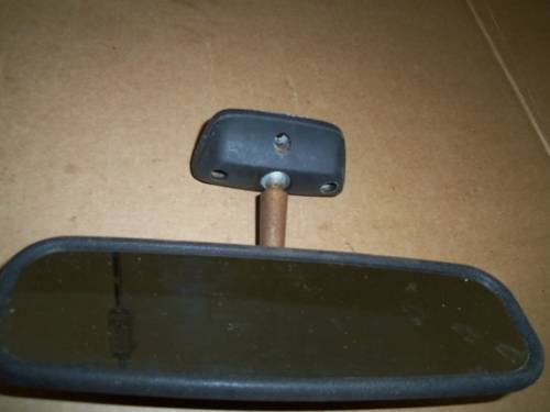

It sounds like maybe your car has the incorrect year mirror in it. The 70 B-Body mirror will have a slot on each side of the base that the rubber tips from the visor inner ends clip into. Some later year/model bases do not have a provision for those tips because the visors were made different and inner ends of the visor with the rubber tips where eliminated

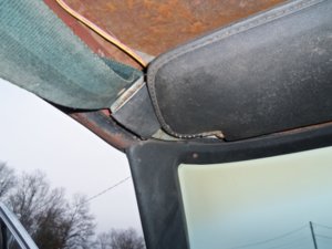

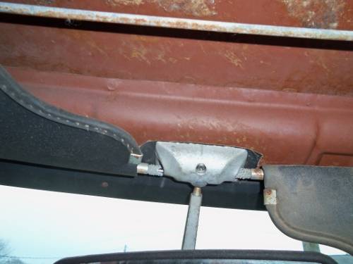

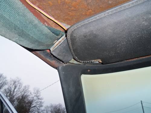

Here are pics of a 68 mirror and visors with the shoulder belt clips intact. Also a pic of a newer mirror, showing the base that does not have the sun visor provisions.
