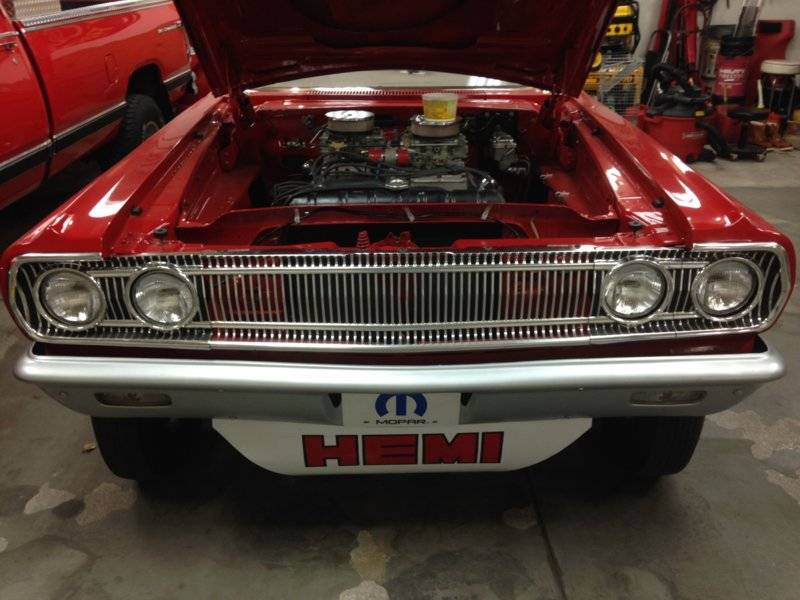

Super Stock grille
The trick is to find an affordable grill!!!
64 grilles (both Dodge and Plymouth) aren't tapered so there's no need to bend the extra pieces...so no difference in " peak" /"crown".

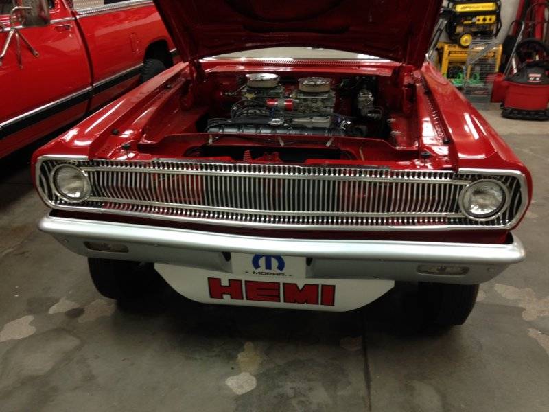

Oh! mine is a single head light to keep with the thread!
I,ve always wondered what a 66 coronet would look like with that treatment or rewire the headlights for high low single beam and run ducts from ithe nside holes kinda like a thunderbolt
basoline: do you have 22 verticles left on the donor center grille? Do you think what you have left would work for a second grille? hint: wanna sell what you have left?
@Ed: check the blog ;-)
@Shopguy: well...I think the "crown" as they called it some posts back, will be too much because the whole grille is tapered to both ends (so the highest in the middle). And wanne sell? Hmmm...I'm in The Netherlands, Europe (yes I am) and I don't think transportation is really good for the leftovers.
Right. You have to use the end pieces as fillers as they are "shorter. The rest of the grille is basically trash afterwards.
