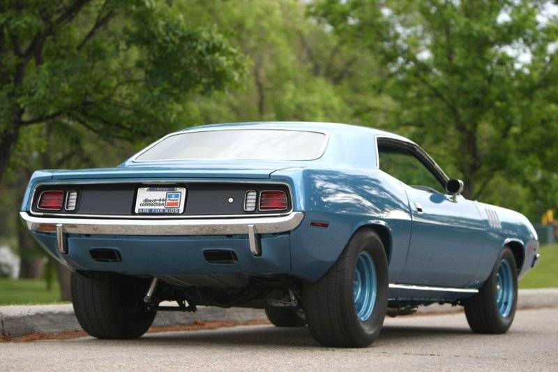

Wheels are cop rims widened to 8" with custom offset to fit the tire in the wheel well. Tires are 295/65 drag radials. Springs are offset.

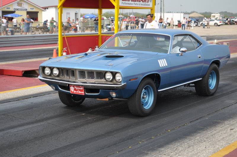

That explains a lot, 30" tall tire. Looks really good.
I'm trying to run a 28" tall tire. So +2" might get me a similar stance in theory, although we are talking apples to oranges with E-body.
