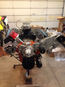

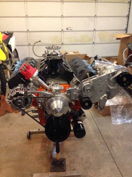

I felt compelled to chime in here. we at sdconcepts will be releasing a serpentine belt drive kit that will feature ulta low ac down on the passenger side with a passenger side mounted supercharger. current bracketry will be setup for a D1SC procharger. if going with our serpentine kit, might want to add on the crank trigger kit we sell as well as the cam position sensor bushing. we will be starting a build here shortly probably around Christmas. you'll have to forgive me its on my challenger. but I do have a 73 charger that will be getting a similar small block serpentine setup right around the same time frame.
both cars will be running port injection with a converted manifold. we sell all the parts for that (bungs and fuel rails). and for the DIY guys you can jb weld the bungs and the brackets to hold the fuel rails.
you can run a 36-1 trigger wheel with our setup and run a ford edis setup in wasted spark. great setup for budget boost building and plenty of tuneability. if you really want to get fancy you can run sequential injector pulsing vs batch fire and go coil near plug if you really want and your budget can afford it.
