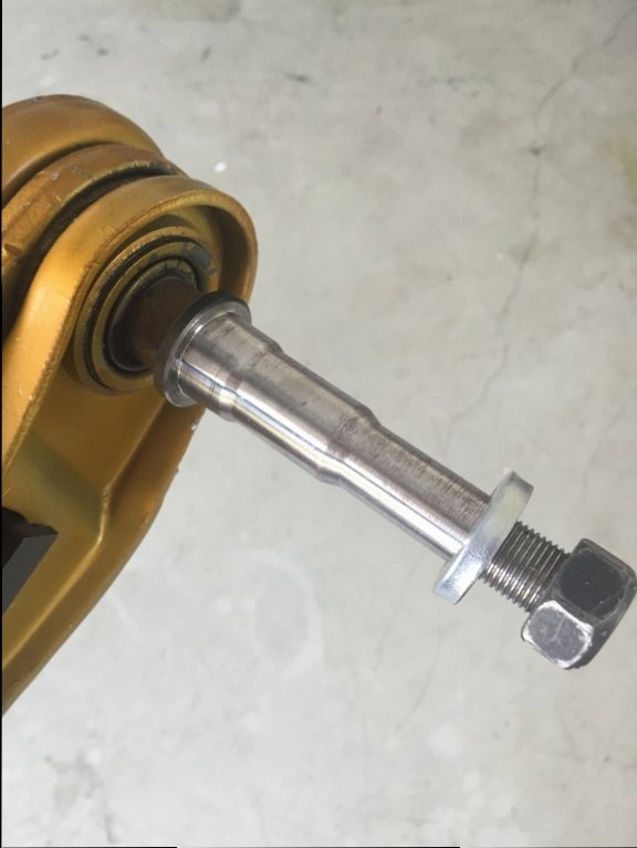

The shaft that is pressed into the lower control arm and goes into the k frame, is that greased at all on the end that goes into the frame?
Nope. Or, only a light wipe of oil. Don't tighten the nut, until the suspension parts are all in place, and wheels are on the ground.
