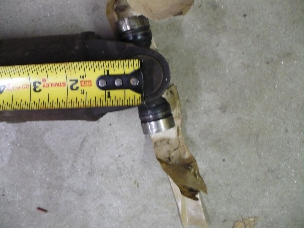

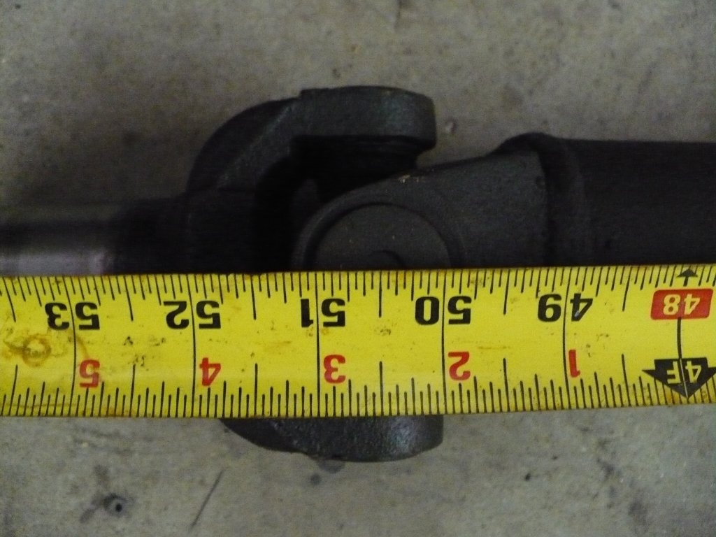

Dana swap is easy B body dana to b body car. As purple beeper said u-joints are the issue and drive shaft is to long. What size cup is on the dana and width of yoke . It could 1330, !.0625" cup 7290, 1.125" cup or 1350 yoke don't know size of cup on a 1350 off hand. 3.625" Outside to outside on cups. You can convert a 7290 to a combo u-joint by removing 2 cups of the 7290 and replacing them with 1330 cups. you need to do some measuring. I have a 68 GTX Dana drive shaft sitting around. 50 1/2" to 50 5/8" 7290 front u-joint and a 7290 on rear of shaft and 1330 cups for yoke.

Dana swap is easy B body dana to b body car. As purple beeper said u-joints are the issue and drive shaft is to long. What size cup is on the dana and width of yoke . It could 1330, !.0625" cup 7290, 1.125" cup or 1350 yoke don't know size of cup on a 1350 off hand. 3.625" Outside to outside on cups. You can convert a 7290 to a combo u-joint by removing 2 cups of the 7290 and replacing them with 1330 cups. you need to do some measuring. I have a 68 GTX Dana drive shaft sitting around. 50 1/2" to 50 5/8" 7290 front u-joint and a 7290 on rear of shaft and 1330 cups for yoke.View attachment 378618 View attachment 378619 View attachment 378619
Thank You very much! These two posts have provided the information I was seeking.
