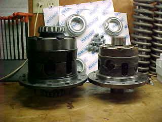

Years ago I replaced an E body 8 3/4 with a B body 60 and with everything else being the same, the weight difference was 50 lbs but the 60 had a spool vs the 8 3/4 SG. The stock Dana SG is probably 15 lbs heavier than the 8 3/4 clutch type but I'll take that extra weight for a better stronger rear. The size difference between the two SG's....
