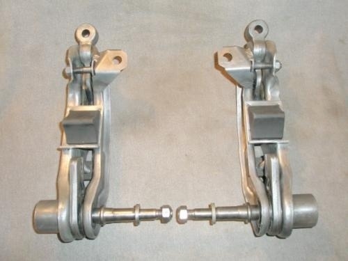

Here is a set of 66-69 B body LCA's with the tabs for the links to attach to.

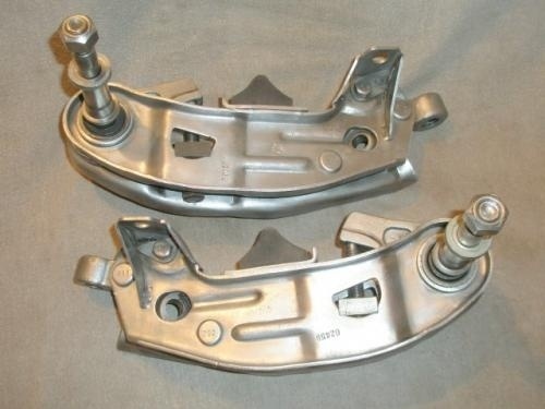

Here is an A body bar with the mounts that attach to the front of the k member. It is the same system for B bodies. This is all if you want factory vs aftermarket.

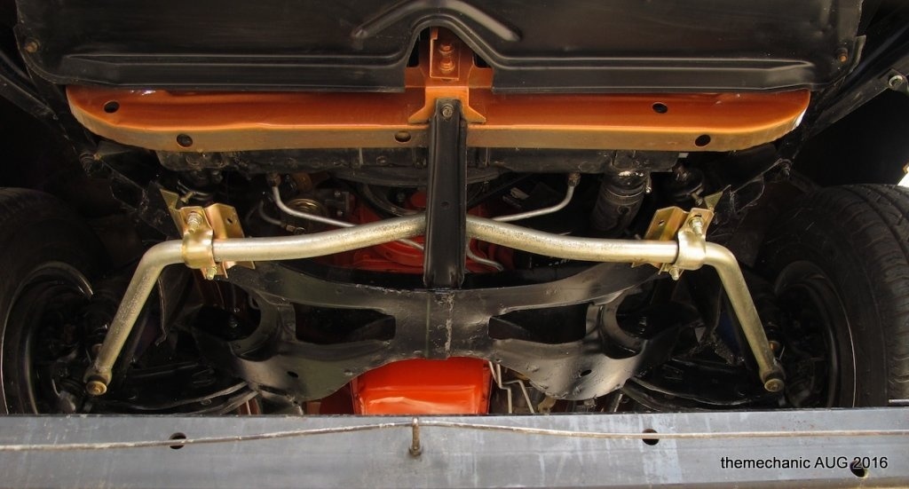

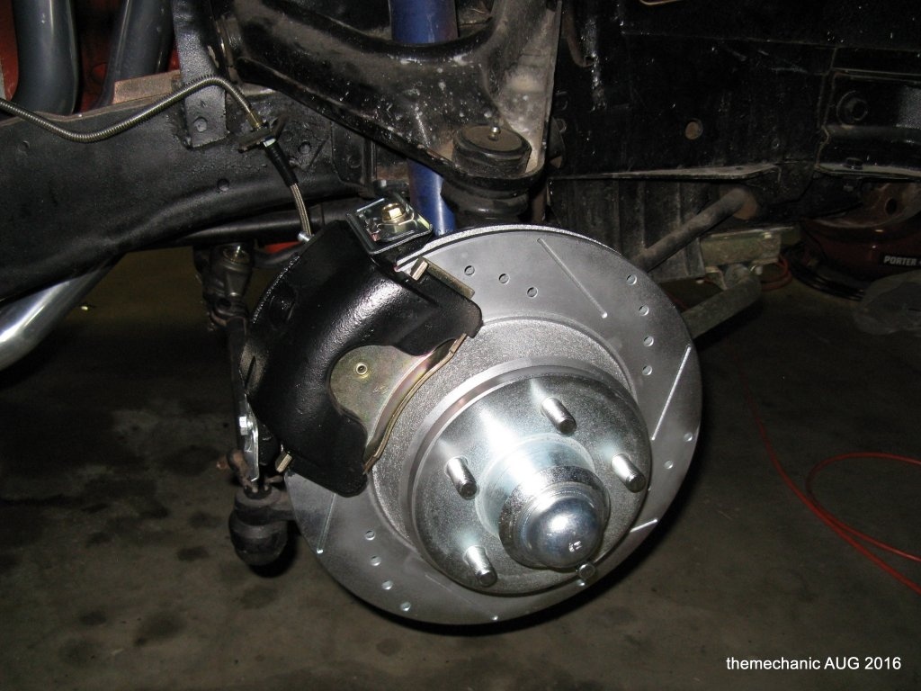

The ADCO is on mine from previous owner. They are just like the Summit one linked to above. If upgrading to front disc brakes you have to get rear mounted calipers.

Mechanic - quick question - what brake lines did you order for your rear-mounted slider calipers? F/M/J style? Or are they kit parts?
