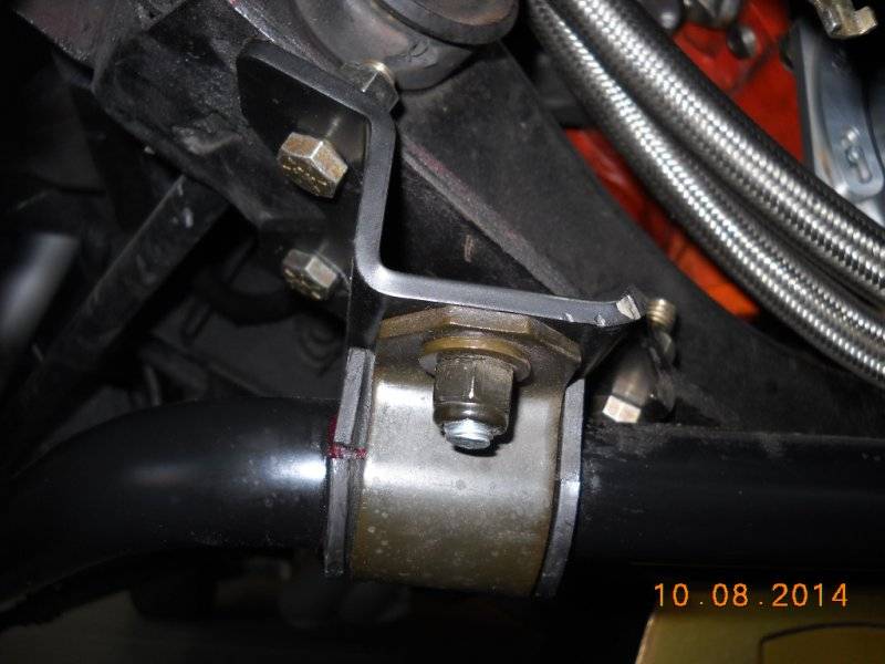

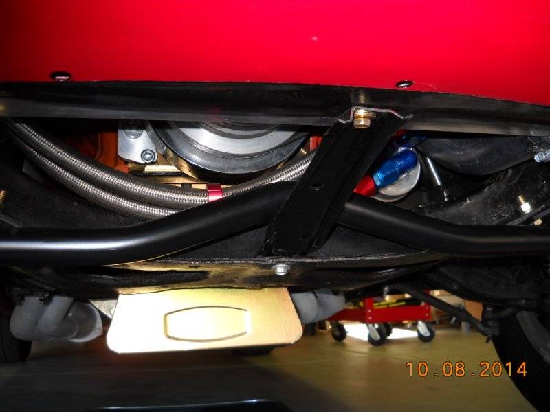

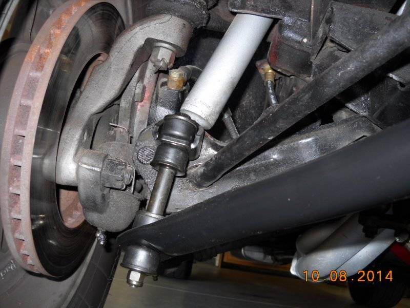

I've had this Firm Feel front bar on my 63 Fury for about 10 years. Easy to install and really flattened out the cornering. Can't help you on the rear.
