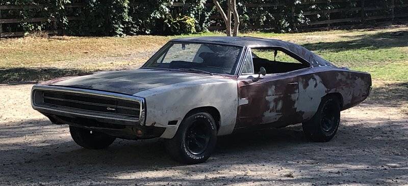

I've looked at this car as maybe a bit of a milder build than my other car.
Less spring rate, smaller torsion bars, smaller tires, smaller engine (383) and a smaller build cost.

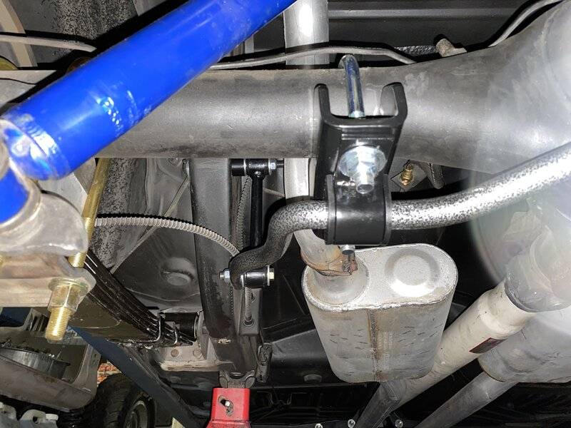

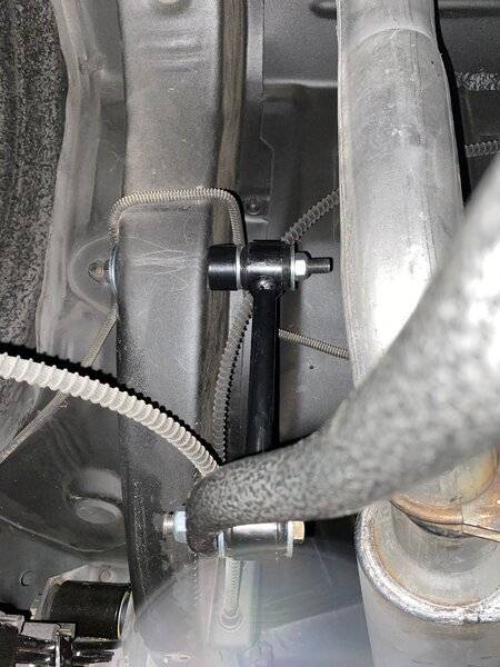

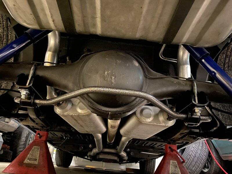

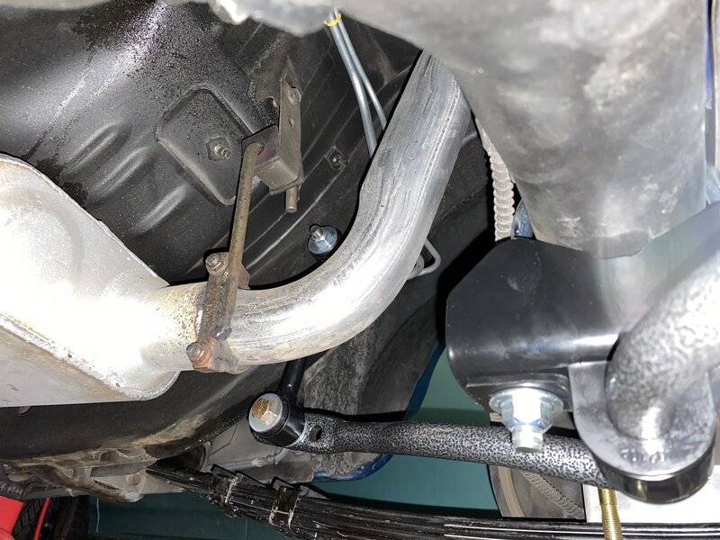

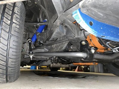

I added Summit Racing brand sways (F- 1 1/8' Part # SUM_720230) (R- 3/4" Part # SUM-720231) and I am very happy with them. Front was $195 and the Rear was $199. Very acceptable on the street and held their own on a high speed road course. The last photo is at Thunderhill in Turn #1, speeds above 70mph. The brackets were great quality. The rear bar was axle mounted which isn't ideal for unsprung weight, but I'm not pushing my car to a level where that is a worry. For springs, I went with Hotchkis 1.10 TB's (PN 19367 @ $334) and Mopar Performance HD Leaf Springs ($135). The rear does have a lowering block in it.
The car is a little rough on bumpy city streets but not enough to want to soften it up. It is similar to my wife's 18' Scat Pack Challenger which I'm good with.
One more thing to note.... The Summit Rear Sway has three positions to adjust to. I'm running the center holes and the car is very balanced.

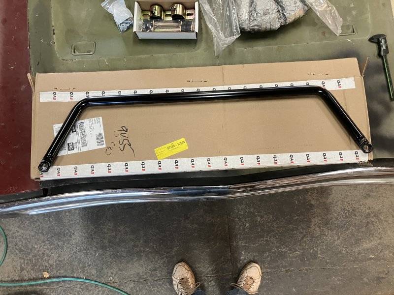

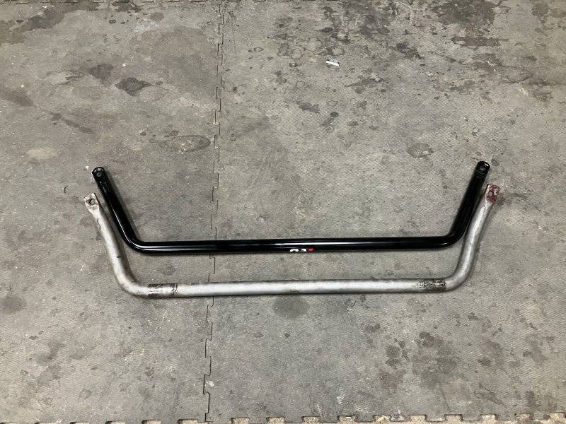

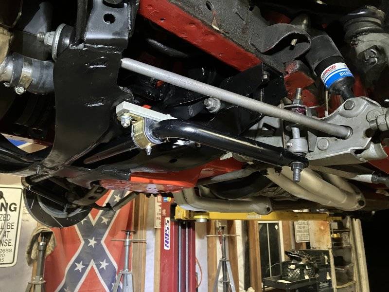

I had a modified 1 1/4" solid bar in my car for years but swapped in a hollow QA-1 1 1/4" car in a few months back.

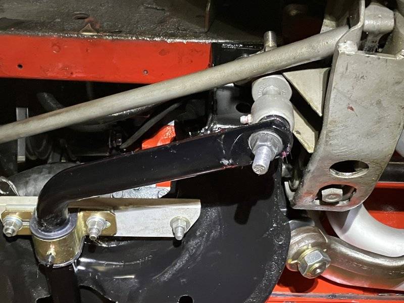

Kern Dog, does that hardware come bent like that from QA-1?
The end links in those photos are modified MOOG parts that actually swivel like ball joints. They appear bent but they move with the arc of the control arm for precise control.
