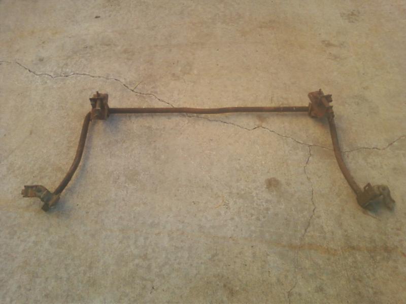

Any idea of what sway bars will fit a 62 Savoy? I am looking to put front and rear ones on but have no idea what works. The local mopar club won't help anyone who doesn't own a popular car.
65 and early 66 b-bodies used a sway bar that may fit a 62. Here is a pic of one that I have. They are a little hard to find but I bought one off of this site.
Some early B bodies did have a front sway bar factory. They are hard to find for the most part. I used to know of a 63 Plymouth convertible in a junk yard that had the front sway bar. I need to go back and take it off if they have not crushed the car.

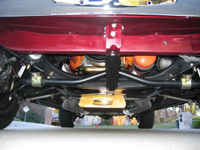

Go to Firm Feel Steering's website--they're Mopar specialists and have everything you need. My car was NOT equipped with a stabilizer bar; this is a pic of their retrofit bar on my 65. WORKS BEAUTIFULLY.
I installed front and rear aftermarket like ilm65 did. I too had a 62' and it required two holes drilled in the K-member like the picture, for the front. For the rear it required 4 holes (two on each side) of the frame/body to mount. Works great though I forget where I got them from. However it just so happens I have them both sitting on a shelf. Complete. PM me if you are interested.
