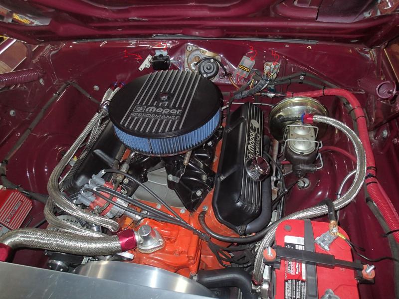

First up is a question to you guys, can anyone please help me identify the components on the firewall marked with 1 through 4

Items in your picture:
1) Factory Ballast resistor. Stock wiring uses this in-line to your coil to reduce voltage. You have an aftermarket distributor and electronics, so this is no longer needed.
2) Factory Voltage regulator. This helps the alternator adjust its voltage to the proper setting. If it is not connected, my guess would be that you have a 1 wire alternator that does not need this.
3) Some non-stock part. I don't know what it is and can't read the text on the part to identify it.
4) Factory starter relay. You will find a small wire that goes from this to the starter, but battery power also gets attached to the large lug on this unit.
Hope this helps!
Hawk

Looks like the wiring was completely redone with aftermarket wiring, due to the lack of bulkhead connectors on the firewall.
This one is connected with one wire on each side. Are there any other way to achieve the voltage regulation? If not - this has to be replaced which I figure is cheaper than trying to make it look good
It's a 30A blade fuse and the fuse box reads "PAINLESS" - don't know if it's to the stereo or not - haven't followed the wires yet. Could be for the head unit though since that's an aftermarket one as well. Amps in truck has 100A fuse which I found in line with the thicker power cable wrapped inside the red tubing.
I think one cable goes to the fuel pump ballast resistor (or so it seems) one to the starter solenoid (as you said) one to ground and one to the ignition terminal. But what I can't find is why there's two separate big wires that goes on the larger connector. Here's an image of it:
https://www.dropbox.com/s/afh2y6oz1kvof1p/Skärmklipp 2014-12-05 17.16.31.png?dl=0
Question: Are there aftermarket ones that are better or should I go with a OEM style Mopar starter relay? This one is corroded and looks damn ugly.

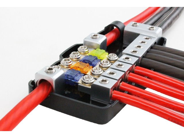

So, the wiring is a bit of a mess (Previous owner CP: Don't take it the wrong way if you read this, I'm extremely happy with the car and you're an amazing standup guy. We need beer this summer in Florida..) two 15 gauge cables going into the inside of the car. One is connected to the battery (probably powering the aftermarket gauges) but the other one is where it gets weird. It splits into two - one with 30A and the other one with 20A fuses on them and then to positive lead of respectively vacuum pump and radiator fan. Seems a bit weird to use 15 gauge cable and then a 30A fuse.
Anyway - since I'm doing a relay harness for the headlights I figured I'd just install a modern style distribution block in the car which has 4 mini-ANL fuses in it. Bought this:
It will hopefully arrive early next week along with the sealed beam conversions I bought. I'm on a budget so I didn't go for the hella ones (300 bucks shipped + taxes) so I went with another brand. I'll keep you posted of the quality later on. Idea is to fit it on the front of the beam that holds the radiator, on drivers side.
The only way to get rid of the voltage regulator is to get an internally regulated alternator. If that's still the old style mechanical regulator, which is looks like from the pic, replacing it with a new solid state regulator might take care of your flickering light problem without relays on the headlights. It took care of that problem on my '69 anyway.

Alright, I might look into that but alternator is brand new and is pumping out healthy voltage so I think I'll just keep it the way it is and set it up with relays for the headlights.

You can get a new solid state voltage regulator relatively cheap. I don't have any idea how much it would cost to ship to Sweden though. I think I paid $25 for the one I got a few months ago from autozone, part #VR706. Good to have an extra on hand anyway, just in case the old one goes out. I had considered switching to a newer denso internally regulated alternator, but I like being able to just swap out the VR if it goes bad, instead of replacing the whole alternator.

As far as your starter relay: One wire should be from the battery, and I bet the other is from your alternator...
That could be it - all pictures I've looked at only had the battery cable connected to the relay. The other cable goes under the engine but is probably spliced somewhere if it's the one that goes to the alternator - or at least has a sleeving on the alternator side because it's not the same color of cable :)
On stock cars, the wire from the alternator goes through the bulkhead connector and feeds the wiring under the dash (as a black wire) and it also hooks up to the one sire of the alternator gauge in your dash. The red wire from the alternator gauge goes directly to the relay through the bulkhead connector.
With upgraded electrical systems, it is common to connect the alternator to the same lug on the starter relay. so this would be my first guess...
Makes perfect sense. I think that's the way it is.
