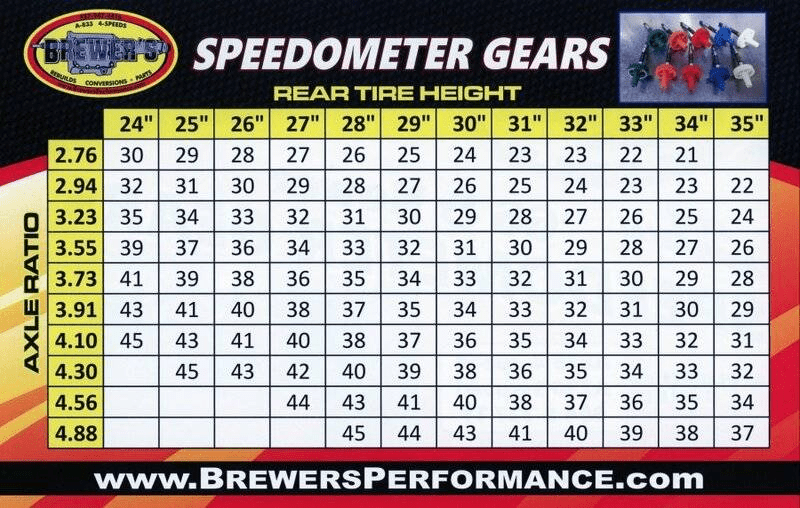

Switching tires on my charger from 60 /14 to 60/15's . How many teeth on the speedo do I need to run in my transmission I've got a 727 auto. ?

brewers has a nice chart on their website, you can look up approx tire diameters on sites like tire rack.

Looking at Brewer's chart, it looks like Chrysler meant their cars to run with a 26.5" tire. That way, you could just take the first two numbers of your rear gear, and that is how many teeth is needed on your speedo gear.
