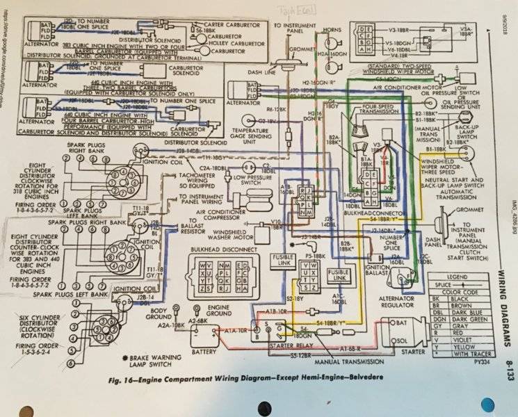

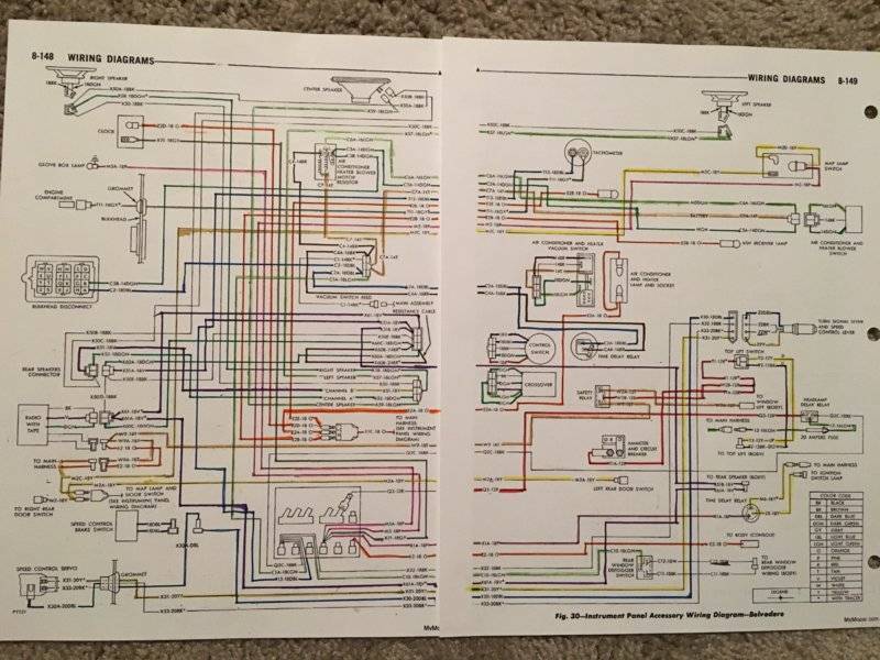

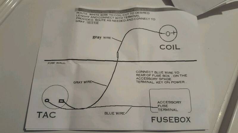

Installed stereo/radio yesterday and knocked the blue tachometer wire connection off. Does anyone have a pic of which connection on fuse box it goes to? Thanks
https://www.forbbodiesonly.com/moparforum/threads/were-do-these-go-dash-harness.169102/
1970 wiring
