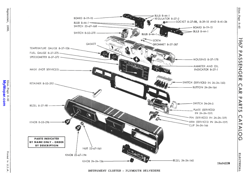

Also based off of a few messages received issue could be the head light switch which might not be too hard to check if I can squeeze my hand back there. Screenshot below of a diagram from a digital service manual that I got from the mymopar site.
I ordered at O'Reilly's part 8-53-270, the headlight switch/dimmer. I'm replacing the headlight switch because it was previously giving me issues with dimming so hopefully that takes care of it.
As with most of these switches typically they get grimy and stop dimming the instrument lights properly, I did use the technique of pushing/pulling/turning to clean it and was sorta getting by that way.
Also I noticed my emergency lights are super dim in the back.

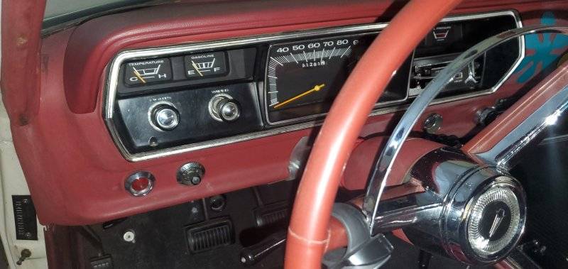

It will apparently suck that I have to pull the instrument cluster, it might be a pain in the 8====D if I also have to pull the steering column to make room for it, at which point I may just replace bulbs while I'm at it, sigh.
