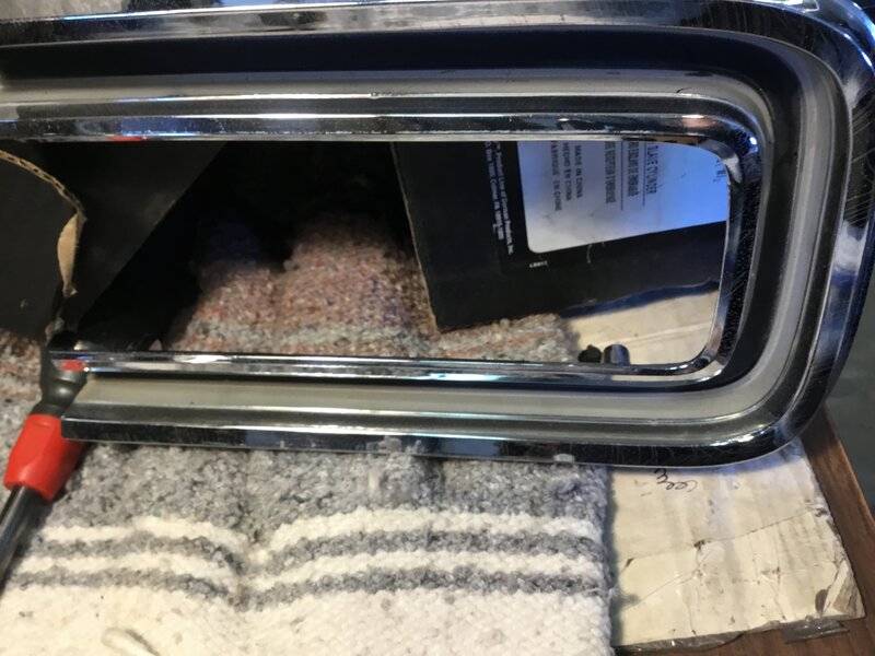

This has most likely been discussed, but I am asking anyway. Does anyone know the brand, texture of the surround paint?
No texture on the 1966-67 Charger taillight paint.
I can’t think of any textured paint on a 66-67 Charger or Coronet body/trim.
Just on the mag style wheel covers.
lots of textured paint on a 1967 Satellite and GTX.
I guess I used the wrong wording.

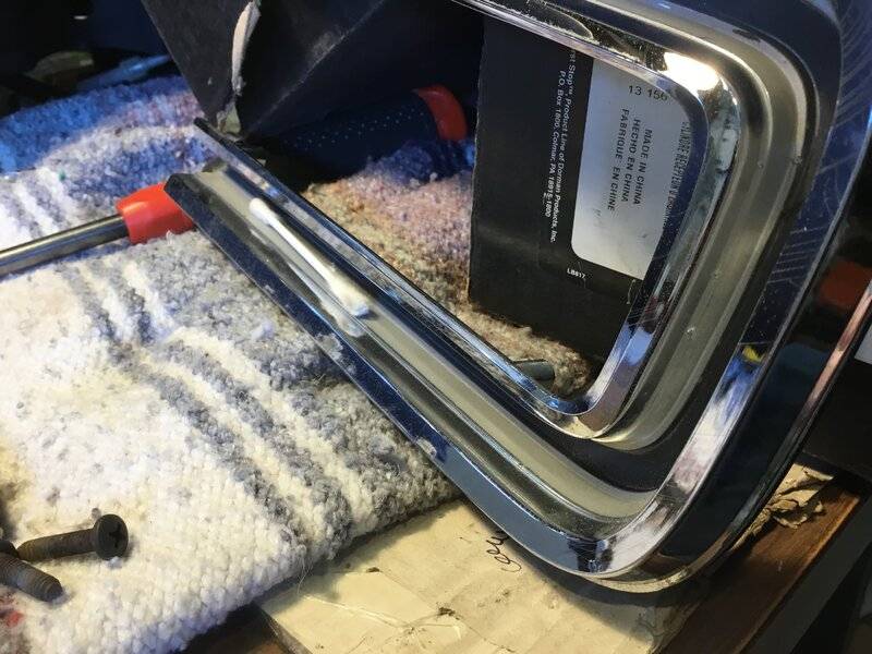

I am referring to the kind of paint and colour, where the q tip is, hope this explains it better.
803124CF-D8B6-45EE-9865-E0928046DA51.jpeg EDC7E039-98A5-4F93-AD8F-88C7F2C6663E.jpeg
Yes I thought that’s what you were after. It’s just silver with no texture. 1967 Coronet 500 and RT Has silver in there also. No texture paint on a Dodge taillight or grille.
The silver part is Plasti-Kote Dull Aluminum #351. Black is almost any black but not gloss. "Trim paint" is spot on.
