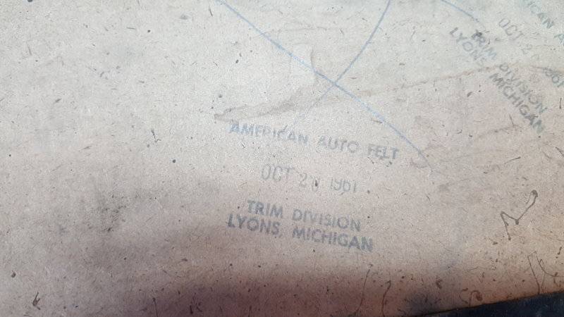

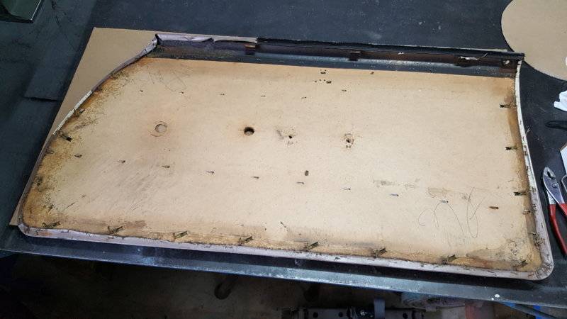

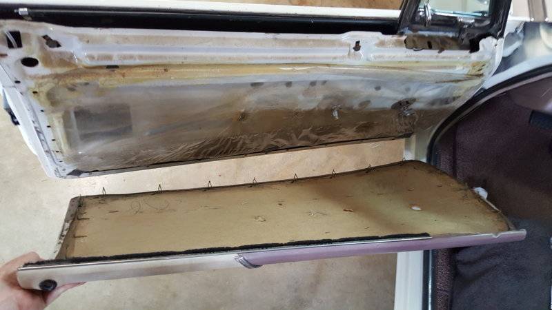

I got this for my Dart 440 as the chrome plated plastic is less than pliable and I need to replace the hardboard headliner, but it looks identical to the plastic in my 64 wagon headliner.
I've never seen so many clips on a panel before. The panels are in good shape. First time they have ever been removed.
View attachment 623999 View attachment 624000

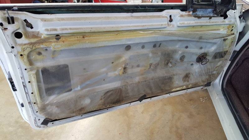

Plastic vapor barrier is in good enough shape to reuse.

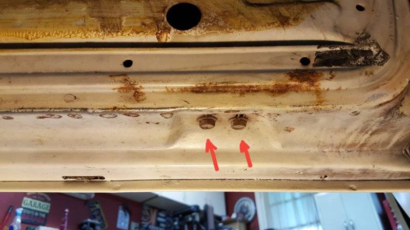

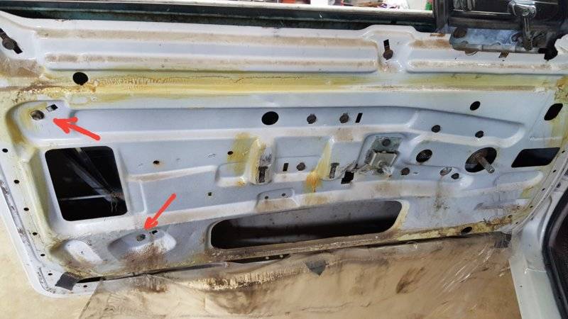

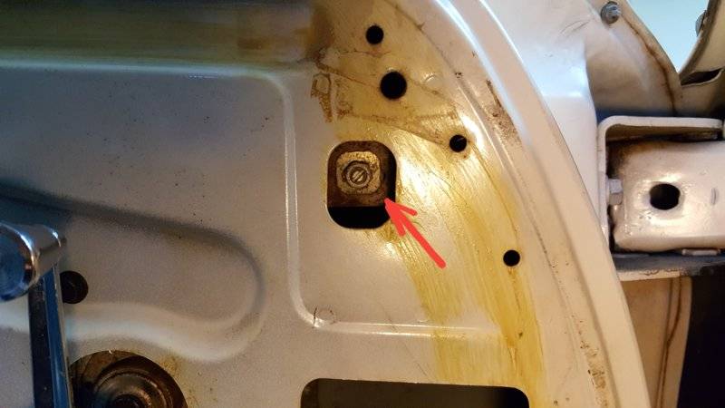

These are the two bolts that hold the rear track in place.

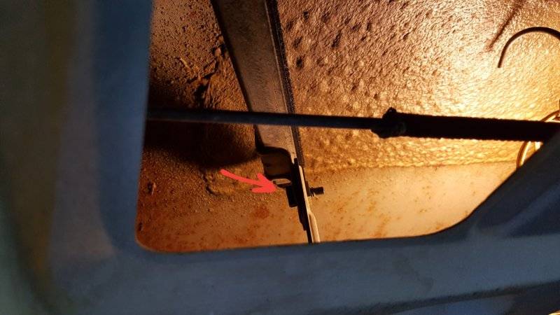

This is the adjuster/stop for how far the window rolls down. We will need this later.
This adjuster sets the wing/track in or out at the top.
These adjust the front track in or out at the bottom.

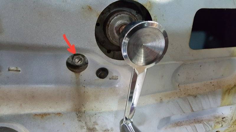

This bolt adjusts the rear track in or out at the top.

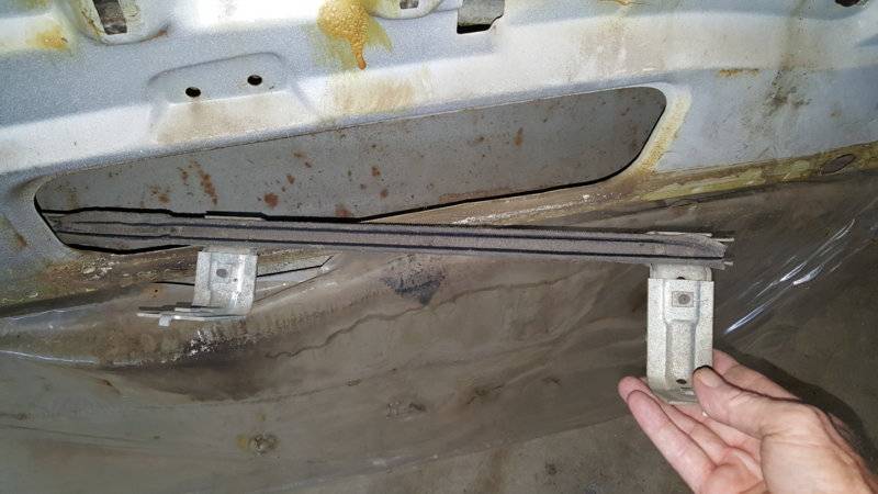

Removing the rear track out through the bottom hole.

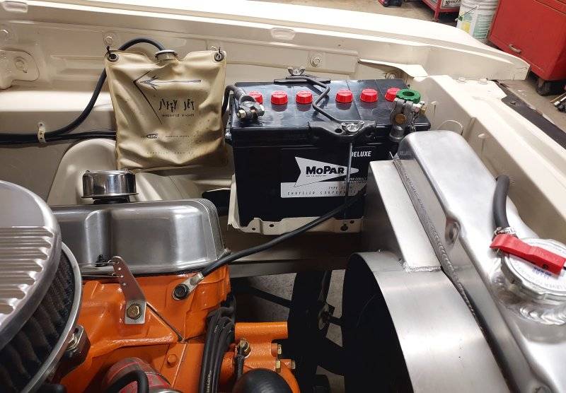

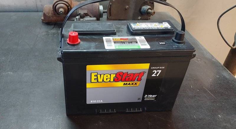

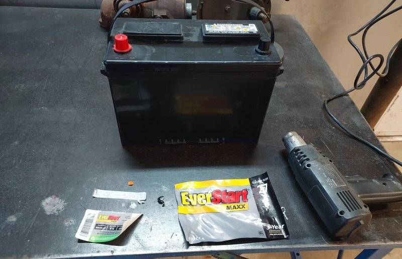

Well I did buy her a new Group 27 battery and installed it Sunday. Waiting on the red caps and Decal. I had to steal the Group 34 to use in the 03 Dakota. This battery is much better!
Happy Belated Birthday! (63 yrs old!)
HBD to the Polara! Hope all is well. The Red caps and decal really do take the pain out of using a new battery. I shared that tip with a few people at Carlisle this year. Its one of those things you don't think about until you think about it.
